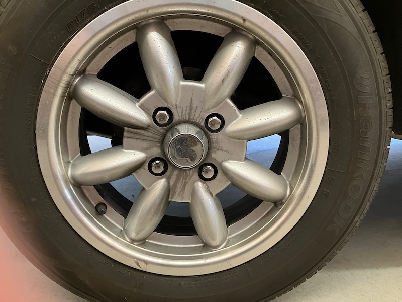

This is on my Morris Minor, front wheel. Same basic hub setup as a Spridget. Haven't had a chance to pull the wheel off and investigate, but I'm wondering what this is evidence of. It's only on one side (LH side front).
It could be axle grease weeping out of the hub.
Possibly brake fluid which could destroy the coating on the wheel.
Another less destructive cause could be accumulated water inside the wheel.
Rub your finger on the stuff and if it's greasy/sticky it's a hub seal, if it smells it's brake fluid.
If it's dry or almost dry carbon it's just water and brake dust.
The way the streaks are running it looks like liquid. Take the wheel off and check for brake fluid leak.

Hard to imagine brake fluid making its way from the caliper to the centre of the hub. I am more inclined to thing grease or even water.
So got the wheel off today and I have answers (and work to do).
Answer #1: What we're seeing is bearing grease.
Answer #2: (To the next question - why?) Bearing is worn. Quick check and I could wiggle the hub. Guessing maybe it heated things up a bit and thinned the grease, or maybe some water got in there (did drive it through some heavy rain a bit ago). Either way, it's time to rebuild those hubs.
Answer #3: (To the next question - how much?) Yes, the budget will take a bit more of a hit. The last time I worked on the front end the hubs (from a Spridget so can use the disc brakes) the hubs and spindles did seem a bit worn. I almost couldn't get things tightened up enough the when I was in there last. I guess they're now all the way worn. So at a minimum new bearings, possibly new hubs and spindles. I can get new spindles and hubs, so may go full out while I'm in there sorting things out.
Not good news but at least the mystery is solved.
