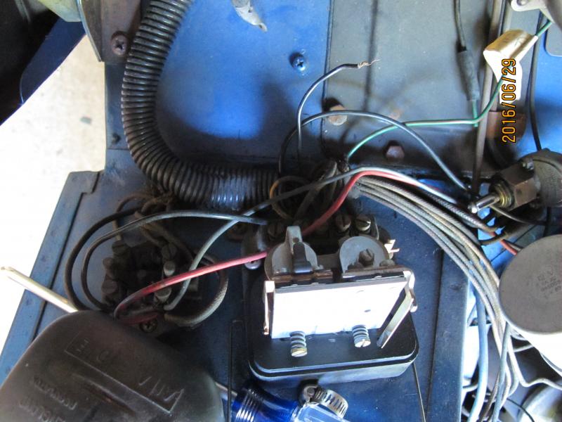

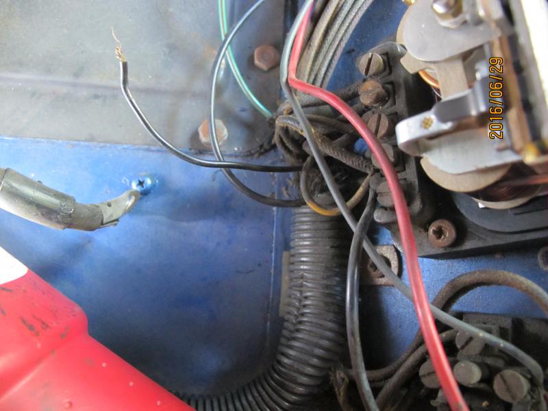

Attached is a picture of a disconnected wire discovered in the Regulator Box. I checked the wire that comes off of the negative battery Post Wire and there is a connection to the regulator box coming off of the main battery Terminal to A. So where does this puppy go? Ideas Gentlemen?
Perhaps to E which shows going to Ground. Tested to Terminal E and E is not currently going to ground therefore I believe it should be to terminal E. Affirmations please.
That Black Wire does go to Ground BTW.

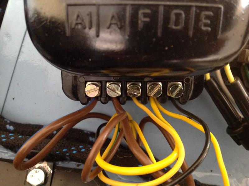

Attached is a picture of mine.

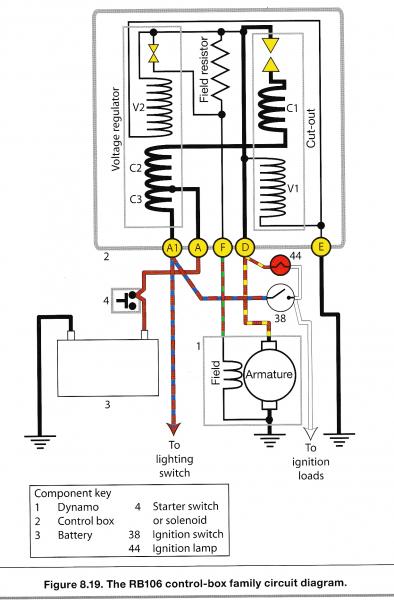

Here's a diagram from Rick Astley's book "Classic British Car Electrical Systems".

That's the way I hooked it up. A few more wires to find homes for. Thanks guys. Bought a battery, I need to replace the helmet type battery cable. I can't figure out how you fasten down unless you drill the battery terminal for a screw to hold it in place.

Fixed. Thanks Team!
