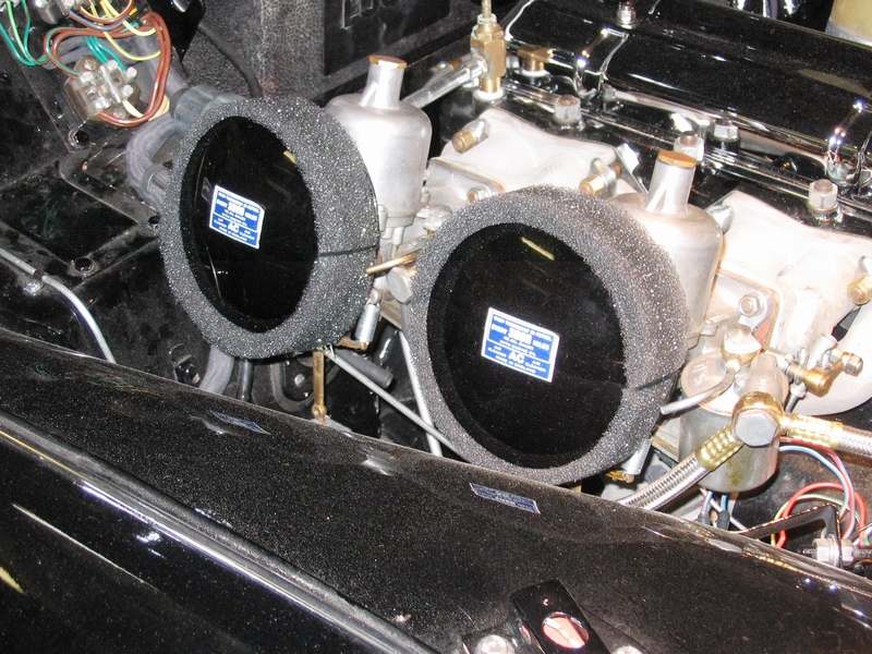

Actually, I run with Piper-X foam socks over the velocity stacks.
I have running the original air filters, still with the original wire mesh inside for the past 54 years. Maybe some of the original bugs are still in there too.
But about 7 years ago, I bought a filter at Sears for an industrial Home-Vac and cut it into 4 parts. I slid these on and added some "AMS Oil for Foam Filters" which I dribble onto the foam.
Hey, Don -
A while back I saw some discussion somewhere regarding potential fire hazards with foam type air cleaners. Just wondering if this was the stuff of urban legends or real...
Obviously, you haven't had any issues in seven years!
I would think that, with Don's setup, the wire mesh in the original filter would act as a flame arrester and protect the foam. I also believe the chance of fire is remote, especially with a well maintained engine like Don's.
But I have personally had a foam air filter catch fire, so the hazard is more than just a legend.
This was on a clunky old Honda motorcycle. Original air filter housing had been lost, so I was using aftermarket foam filters. It had a tendency to 'sneeze' back through the carbs occasionally and that time it was enough to set the filter on fire. Fortunately I was able to stop and rip the burning filter off before it did too much damage but I gave the bike away rather than fix it.
My friend rode it occasionally for a year or so, until it 'sneezed' again and set the vapors from a fuel tank truck on fire. (He was starting it in a filling station that was having its tanks refilled and apparently there was a layer of fuel vapor on the ground.) Again the fire was put out without too much damage (none to the station or truck), but he junked the bike. Sometimes "free" is too much to pay :smile:
