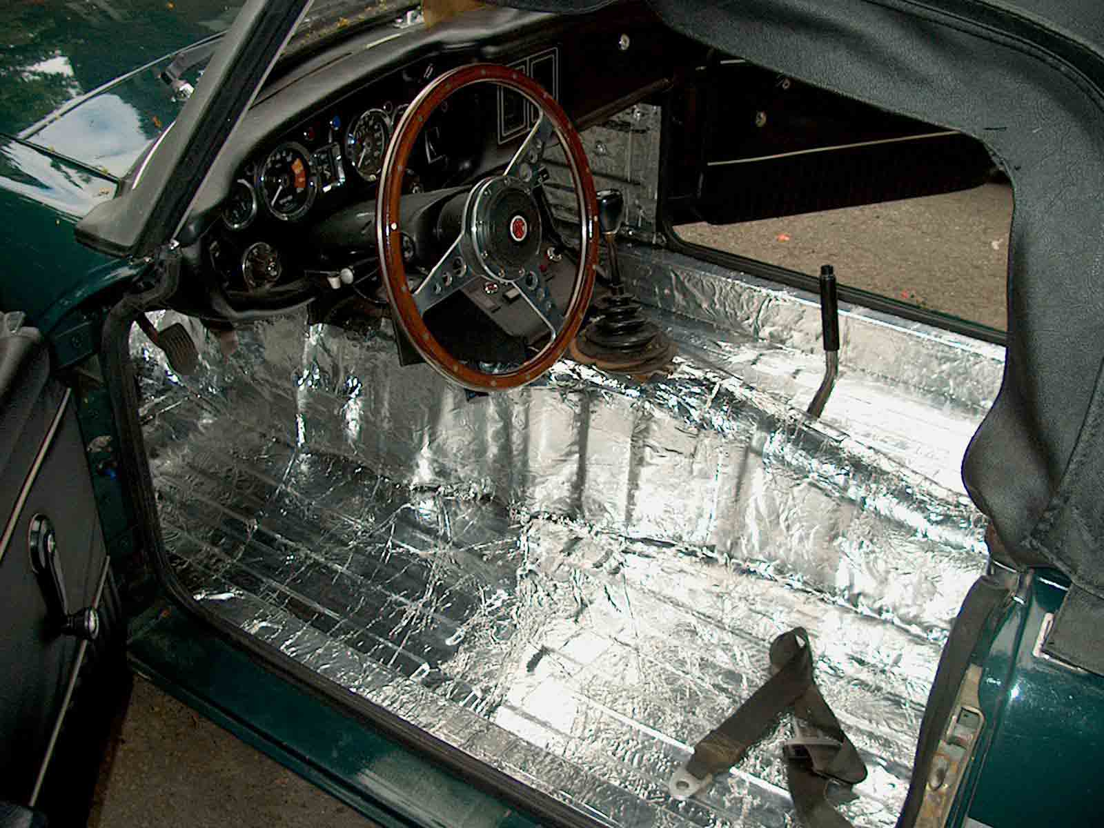

The biggest improvement I made to my B was sound deadening material but it goes inside the car not under.
Here the link to the company that I bought it from.
https://www.b-quiet.com/
You may also want to look at the picture I am attaching which shows the results.
The noise level in the car really went down alot.
The floors were already repainted (my car was totally rebuilt which included new floors). You need to apply this stuff on painted surfaces. You may also paint it but I do not see the value since the carpet goes over it.
One thing for sure now the steel floor is totally isolated from moisture (you need to apply it when the car is totally dry and in warm weather.
