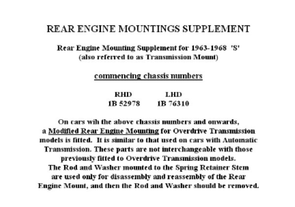

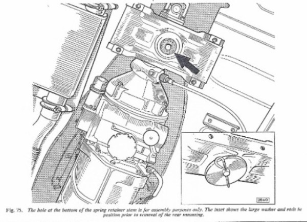

you are correct, the piece of wire through the Peg, is/was for servicing purposes, as in "removal of the crossmember", then it needs to be removed for the peg to travel up and down. A Cotter Pin instead of wire would have been the preferred "piece of wire".
A Service Bulletin was issued in 1964 for the 1963 S type; it looks like Service depts. left the cotter pin in place after replacing the rubber in the crossmember or the transmission causing a "thrashing" of the transmission during driving.

there you go. was there a large washer under the large cotter pin too? both the cotter pin and the washer need to be removed per the SB. The transmission needs to have free up and down travel according to engine and driveshaft torquing. The rubber or spring are there to help the tranny go back to "zero" or "level" position once the cotter pin is removed.

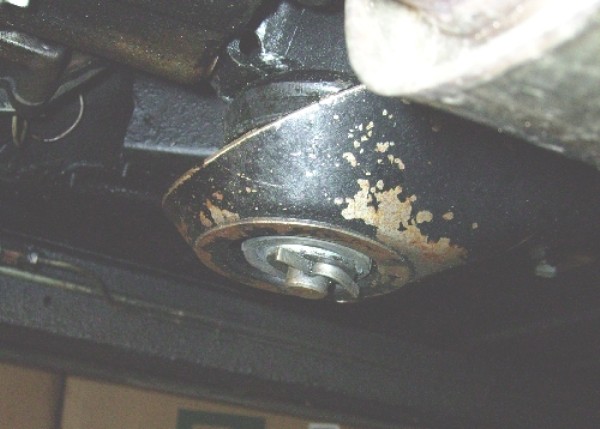

here's how mine looked before removing the cotter pin and washer...
