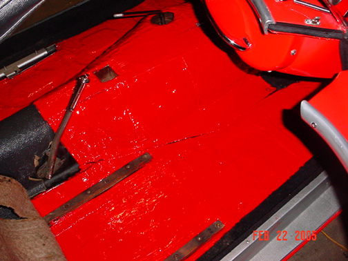

One advantage of the Dynamat is that rolled down over clean metal, it will exclude all water contact with the underlying floor. Note in the pic attached, two layers of Dynamat are tightly rolled down to the clean floor & all is sealed with body color paint. The jute & carpet are loosely laid over this "new" inside floor & secured with snaps.
