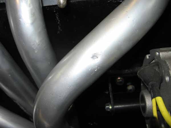

I think I found the problem. Look at the pic. There's a small dent in the header caused by the darn stud on the intake manifold that I never removed!! Had to have caused the manifold not to seat. I can see where the top of the manifold gasket is indented slightly, but nothing on the bottom.
I'll recenter the jets, and then put it back together again and see what happens...after I also unscrew the studs on the intake manifold. :wall:

That would do it!
If memory serves, I've been told that those 4-2-1 headers won't work with the stock TR3 intake manifold. So also check higher up for any interference.

OK guys, I removed the studs on the intake manifold, put it all back together. Primed the carb floats, pulled the choke out, turned on the ignition, and then used a screwdriver to bridge across the terminals on that lousey relay switch, and the sucker fired right up. :banana: :banana: :banana:
I ran it about twenty minutes at about 2k rpm to seat the cam. The electric fan kept everything at about 190 deg., so I was glad to see that. The carbs need to be balanced as I just slapped everything together, and there are a mess of other small adjustments to make. No major oil leaks...a drop or two on the floor. I check to see where that might be coming from at another time.

Randall, that header took alot of tweaking to get to fit. It caused me more grief that any other mod I've done to this car. It'll fit with the TR3 manifold, but it ain't easy. Oh, and don't forget to remove the studs from the bottom of the intake manifold. :lol:
