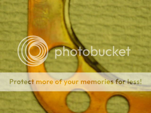

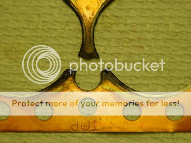

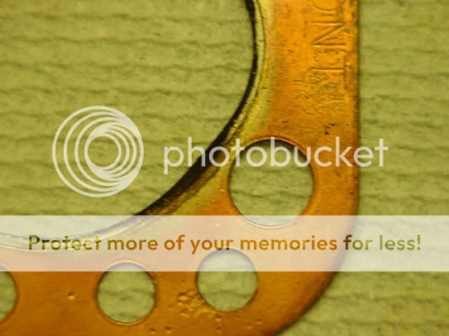

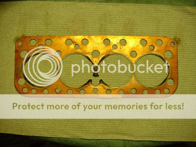

Discovery, Checked compression on #2 and it was 75 and number 1 was 150. Pulled the head. Pistons fine, valves fine, head gasket blown big time. I see what happened after checking it out. It is the wrong head gasket. Its been so long I cannot remember where i bought the set, but the head gasket appears to be for a Mini or a Bugeye. The gasket hanged over the cylinder and there is a hole in the gasket between 2 and 3 that was stamped in there, but the over hang left almost no gasket meat to seal between the cylinder and that hole. Pics in a minute.
At least now I know what the problem is and that it was not a burned piston or broken valve or due to my carb fiddlings. I am ordering 2 head gaskets, one for the emergency spare. I did this for a pickup truck once that had blown a head gasket and I thought might happen again. Just peace of mind.
