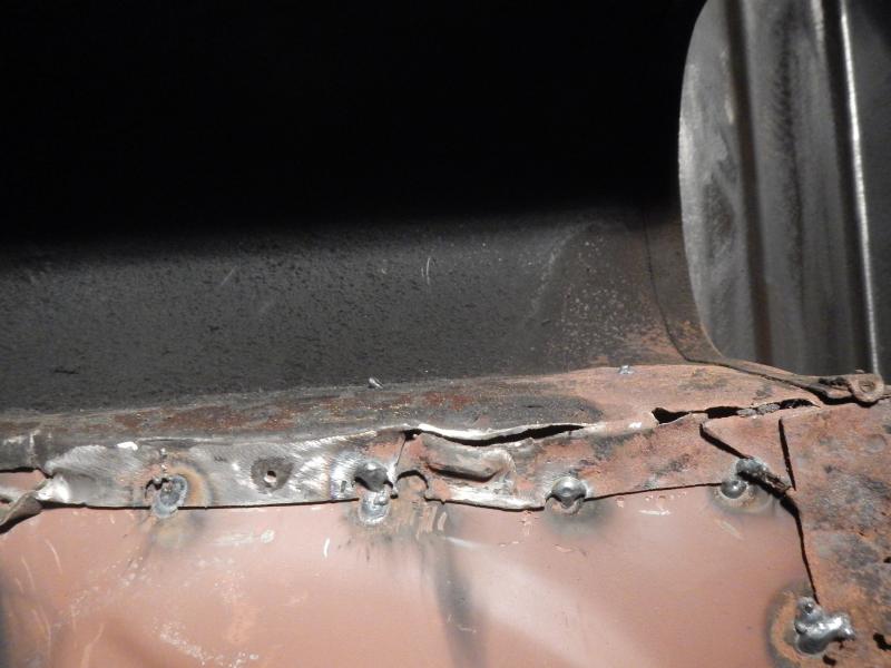

When I get the tub off again and on its side I need to fix the POs work on the floor to tunnel welds. The Tunnel needs some repair work first.
David
Ouch! The P.O. Must have figured, If you can not see it , it is okay.

At some point I think the PO brought his boat building buddies in to help. I have had to remove a lot of fiberglass mat work that was hiding holes in the fire wall and kick panels
There is rust along the floor to rear shelf lip to address as well as the tunnel problems.
