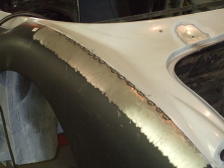

I have a Hobart Mig welder that I bought about 15 years ago and have done complete restorations on about 5 cars with it. I think it is a Handler 140 but not sure. They have changed the names of the machines since then but this one plugs into a 120v wall recepticle. I have done everything from really fine metal work up to repairing frames. It is a gas shielded welder. I couldn't be happier with it. Here's a picture of some welding done with it, and as you'll recognize that weld bead is Very close to the aluminum shroud. That Handler 140 provided alot of adjustability to be able to control the heat and the speed of the wire. I was welding the fender flange back on because I had cut it off in order to shrink the fender.
