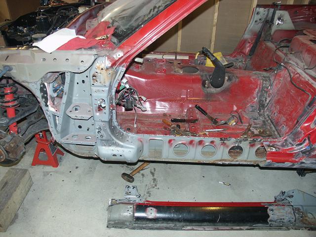

I have a Lincoln Power Mig 215 and it is a little oversized for some work. The real drawback is that there are two different gun sizes, 100A and 250A. Although more rugged, the 250A gun is tough to use in tight quarters since it is also bulkier. This is the Miata over the winter. I’ve learned to despise spot welds.
