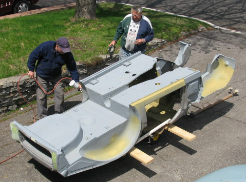

I weighed the TR4A tub when I was flipping it over to work on the bottom. Including the metal "exoskeleton" I built to hold the tub together and not deform as well as hold wheels so I could push it around, the total weight was 400 or so pounds (assuming putting a bathroom scale under each leg of the frame in turn and adding the weights gives a valid figure). Go to my web site and check out the pictures on my TR4A page to see what I am talking about.
As Don said, four of up were able to pick it up with ease. And six of us were able to flip it over with ease though I don't think with the running around and pictures being taken did we ever have all six on the tub at the same time.

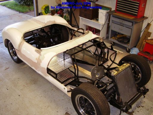

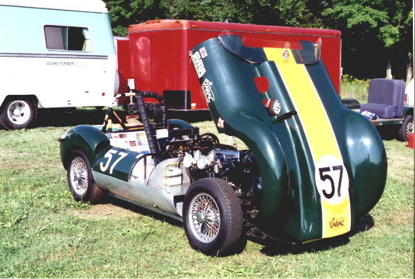

Wyotech is where the students (and maybe a few profs too) are assembling a new and real replica AMBRO based on an early TR3 with TR frame and all the running gear. The original ones were built around 1958 to 1960. I photographed the green one in 1996. The white one is what is being assembled for Joe in Iowa.
