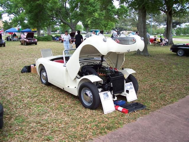

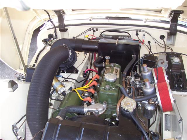

Clean clean clean
And even cleaner.
And then.
Hehe, don't panic. The main thing is to go and have fun. Meet folks and talk cars.
It don't get much better than this.
Enjoy.
