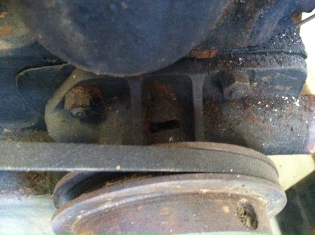

RD said: "My '60 BN7's water pump, which surely isn't original to the car, has small hole in the top"
I believe that some pumps had weep holes on top--designed to give an early warning that water is getting past the seal.
Is this the hole you are referring to? I know that my pump is not original as I replaced it, twice, in 1979. The pump had failed on the Healey, and my dad was out of town, so I could not drive the car. A replacement was on the bench, so I decided to take a crack at replacing it. I messed up the hand-cut gasket, so out the radiator and pump had to come again. Second time a charm, and it has worked fine ever since. The engine is now awaiting a complete rebuild.
