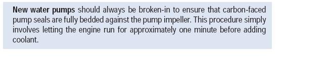

Lou Metelko said:
Don't remember where I heard or read that instruction
Probably read it in the Moss catalog:
Yeah, carbon seals were used into the fifties, but I don't believe any TR came with them, much less any replacement pumps. Phenolics have all but replaced carbon many years ago. As far as ceramics being used in water pump seals, those are used as a seal face for the phenolic part of the seal. Years ago, the cast iron of the impeller or the pump body itself (as in the original TR pumps)was the other mating surface. Sintered iron and other surfaces have also been used. I used to rebuild water pumps years ago, and if the mating surfaces are up to snuff, a dry spin up is unnecessary. Also, pump seals do drip on occasion, one of the reasons for the "weep" hole in all pumps. Newer style unitized seals have all but eliminated this, but they still have the holes so if the pump does leak, the coolant won't wash the grease out of the bearings. Original Chrysler slant six pumps had a trough to catch and channel away any drips so they wouldn't get on the fan belt causing slippage.
