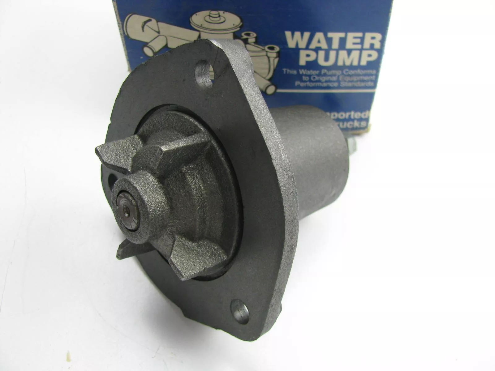

The pump which failed and I replaced looks exactly like this one (Water Pump - 2). The vanes measure 13/16" from the base of the water pump. It was stamped with "PC11A". I don't know the source as the PO installed it but, it appears to match Quinton Hazell part #131-0960.

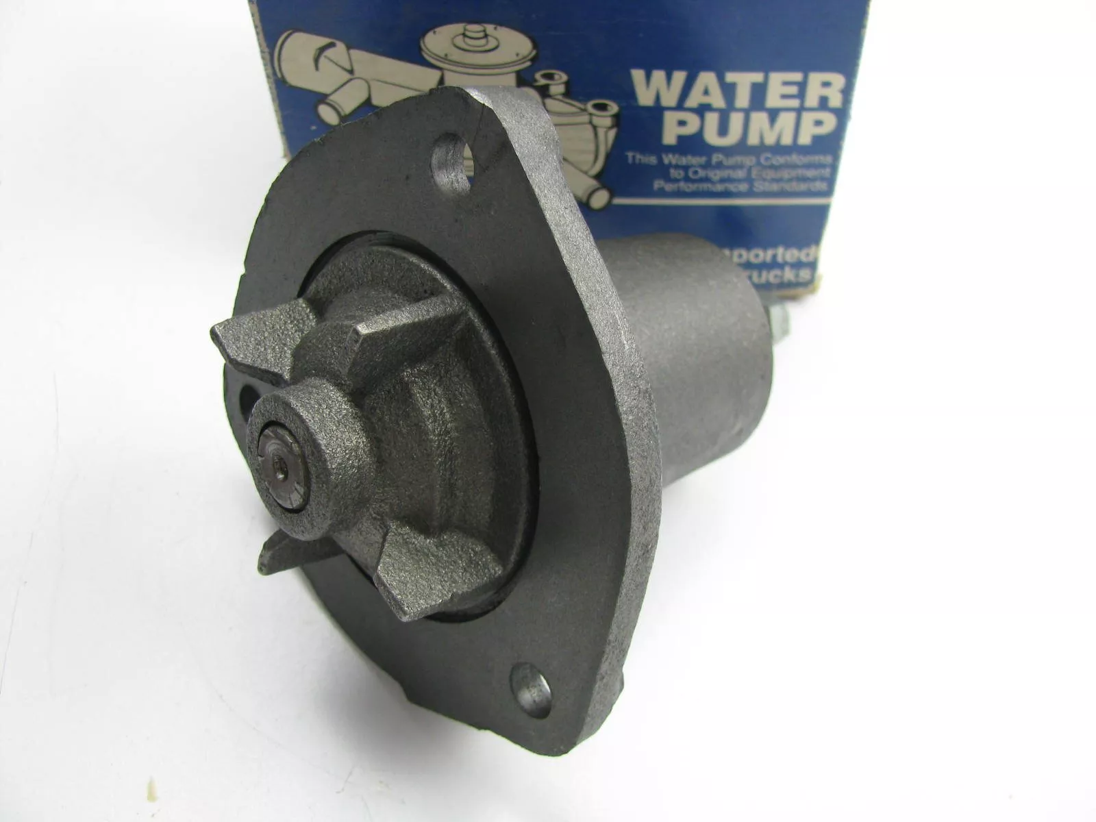

Otherwise, everything currently available from the big suppliers look like this one (Water Pump - 3). Back in July 2012 I had ordered one (Moss #835-070). I ended up returning that one as the 4-vanes only measured 11/16".
The "up-rated" 6-vane pump has performed well for 12 years and 6,000 miles. But, on the very rare occasion when the car is stuck idling (650 RPM) in 85*F+ temps, the water temp will rise. I am running a completely stock cooling system with original TR4A fan and radiator (boiled and rodded-out - coolant flush and refill every 2 years). Before installing, I measured the vanes. They are sloped/ beveled such that the leading edge on the vane is 11/16" and the trailing edge is 7/16".
I am curious on other people's thoughts/ experiences? I still have the original water pump and thinking I may rebuild for if/when the "uprated" 6-vane pump fails.
