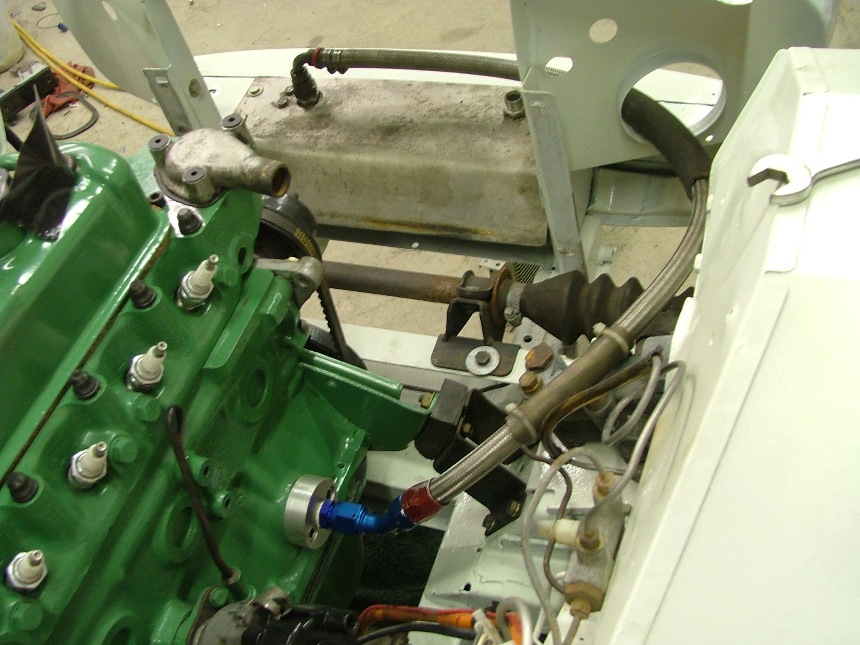

This is a 948 outlet housing on a my 1275.

I would like to point it straight ahead or if necessary to the left. I have a remote radiator and electric fan. Does one flow more than the other? I would think that if the hoses were the same diameter it wouldn't make a difference, but who knows?
