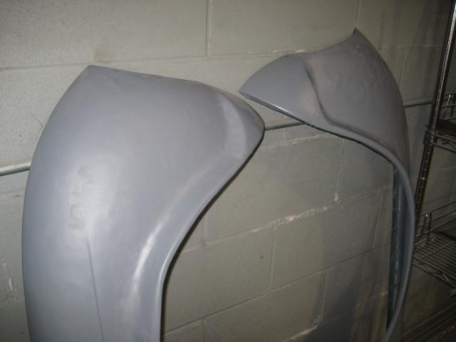

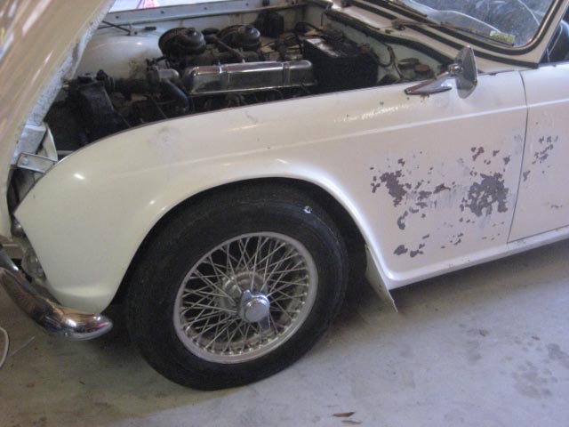

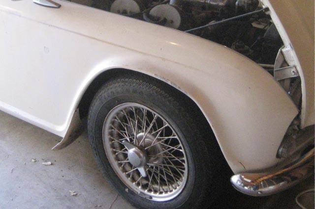

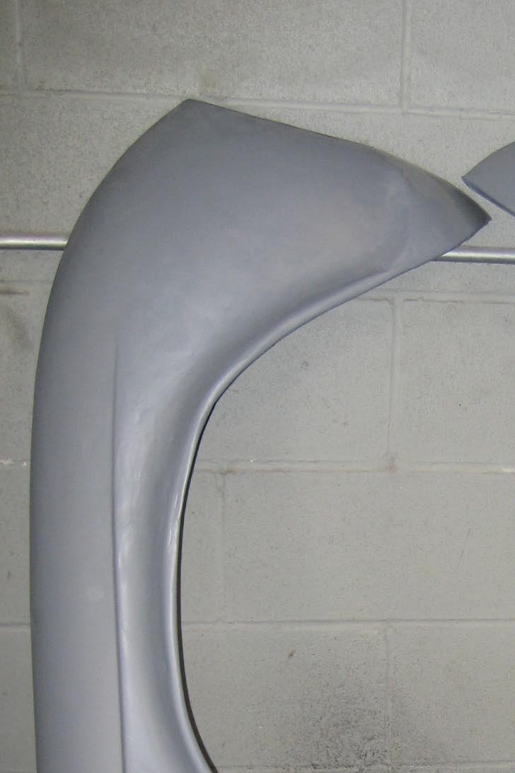

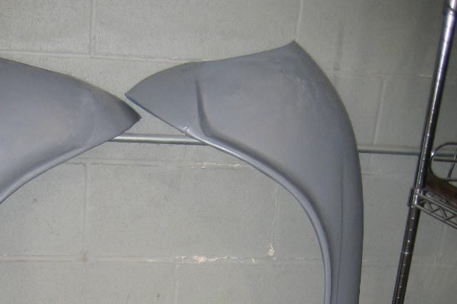

Here are some before and after pics. Damage doesn't show up so well unfortunately. Wheel arches are also mishapen although you can't see that too well in the photos. There is also a crease in the rear of one of the fenders too.
Myles

The left fender looks to be pretty simple to repair. The right hand fender flare is mis-shapen quite a bit. A good hammer and dolly guy could reshape those. That would be the hardest section to get right. Ask around your area to see who does hammer and dolly work on older cars and bring in the fenders and see what they say. If you're going to go with used fenders, I would just concentrate on the right (mis-shapen flare) one. That might be a toss-up on whether repair or another fender would be least costly. At the price of new fenders ($1400) it pays to check out alternatives.
Edit: another problem with used fenders, is that most of them are rotted on the bottom, and will need a repair panel welded in. In that instance, it pays to just repair what you have. So watch carefully for that.
I have a pair that is ready for top coat but they have rust repair panels where the most (but not all) of the rot was cut out and new metal welded in from behind.
They look good, are are more than fine for a driver, but are not concourse quality to be sure.
