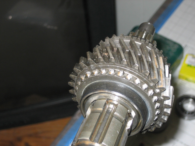

i need a new second gear....
my budget is less than $100..
anyone have an extra gear to
part with or a good resource?.........zimmy

22G100- layshaft.... 22G1121-2nd gear

No, just wanted to be sure they fit, I had one box with an oddball laygear. Check the layshaft and bearings for wear, usually the laygear breaks teeth before it really wears too much. I'll let you know what I find.
Always a good idea to just put in a new layshaft and bearings, Jimmy... it's a PITA to have to do it all again, IYSWIM. If the shaft shows ANY wear, put in a new one. Visual evidence of galling, or the "fingernail" check will tell. Drag a fingernail down the length of the shaft in four equidistant lines (think diameter quadrants)... if you feel a "hitch" ANYPLACE along the shaft it's time to replace it.

the layshaft appears fine and i have new bearings
already.....my laygear has wear between the teeth
but none are broken....this tranny rebuild is starting

Check that part #, 22G1121 is 3rd, 22G1120 is 2nd. Let me know which you need.
