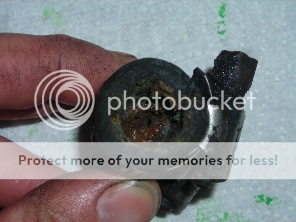

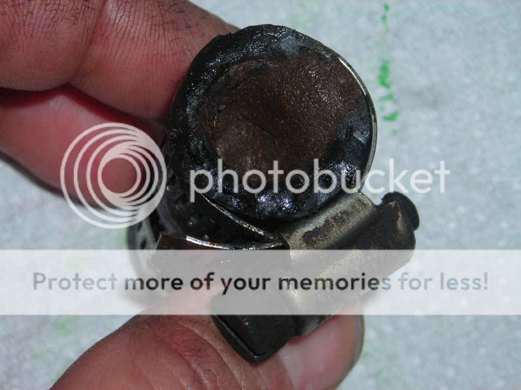

Want to see something scary?
tdskip
This is the bypass hose as I pulled it today from the elbow/thermostat assembly.
and
Totally blocked solid - yikes!
Good thing you comments on the other posts regarding the thermostat prompted me to rebuild the rest of the cooling system (in addition to the already recorded radiator)
Mmm, brown sludge!
I'm sure most of the cooling system in my old 948 looks a lot like that. Yucky!
