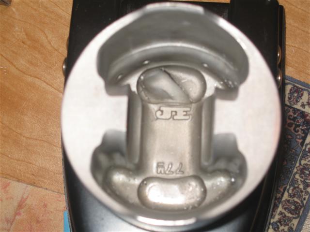

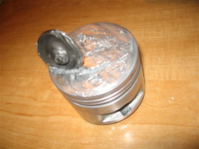

A few months back I dropped an exhaust valve--the tip came off the stem where it is notched for the keepers. When I pulled the head I found the valve jammed firmly in the seat at a 90 degree angle minus the stem which made its way out through the port and into the header.
See the attached photos and notice the indentaton on the underside of the piston just above the "JE" logo. I have epoxied the valve into the deep groove it made in the top of the piston for the sake of history.
I recently got through rebuilding the engine and the only thing that died was the valve and the piston. The rod checked straight and the crank and block passed a crack test, though I did have to sleeve the one bore.

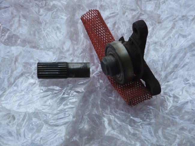

Here's another trophy--this is the end of a hardened axle that broke off in the pumpkin. Luckily I could just get the third member out of the housing and was able to drive out the stub from the other side.

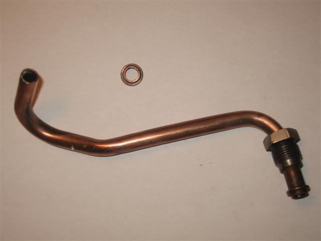

I was doing some adjustments to distributor advance timing on my 100 and making some fast highway runs to see what effect they had on engine temps. I was keeping a close eye on the combined water temperature/oil pressure "safety guage" when suddenly the OP needle dropped from 60 psi to perhaps 20 psi.
I shut down immediately and got towed home. When I dropped the pan I found that the flare nipple on the copper pipe running between the oil pump and the block had broken off at the block connection allowing most of the pump's output to blow back into the pan. I replaced the pipe with a modern oil line with swivel fittings--no damage done but a close call.

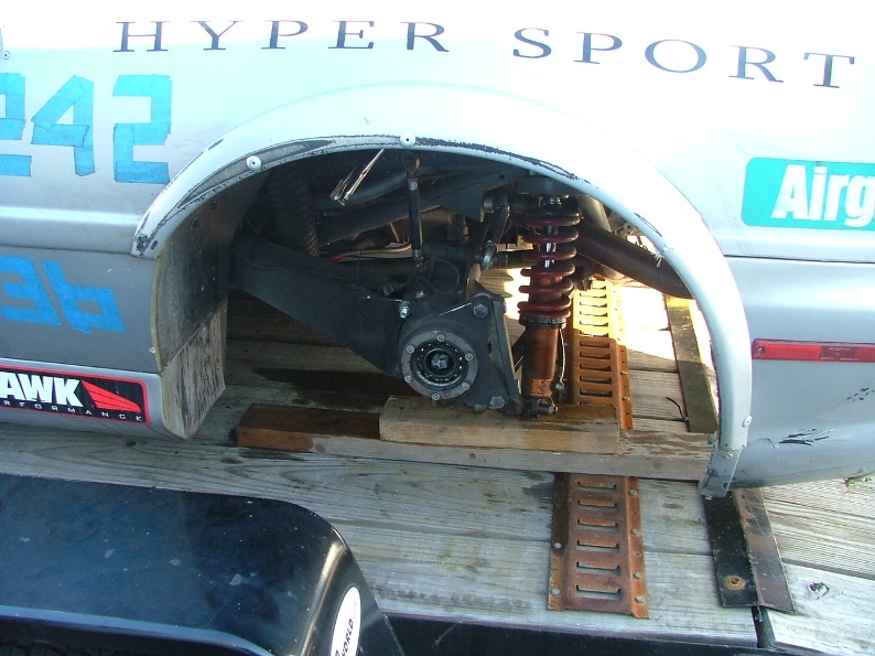

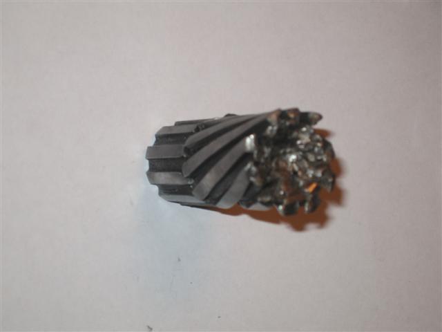

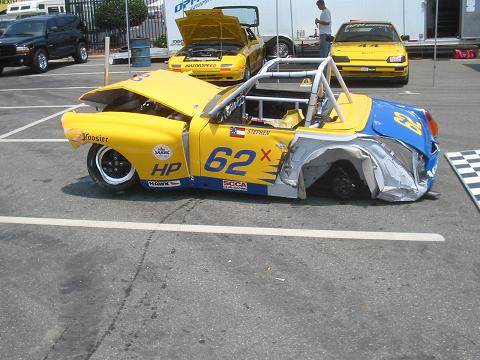

I think everybody who races a Spridget rear end has one of these...
Or a +2 Lotus owner with a heavy boot...
Not mine but speaking of Lotus - This was an Esprit at New Hampshire this year. Had it back on the track the next day.
