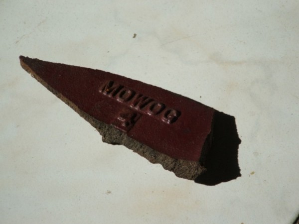

You could view what was left of the con rod, oil pickup and crank through the space this piece vacated in the side of an MGB-GT block. Engine had been into before we bought the car, unbeknownst to us. It grenaded itself on the Mass Pike at West Springfield, 11:00 PM. First Wife at the helm. Long story.
That's a keeper (the piece that is )lol

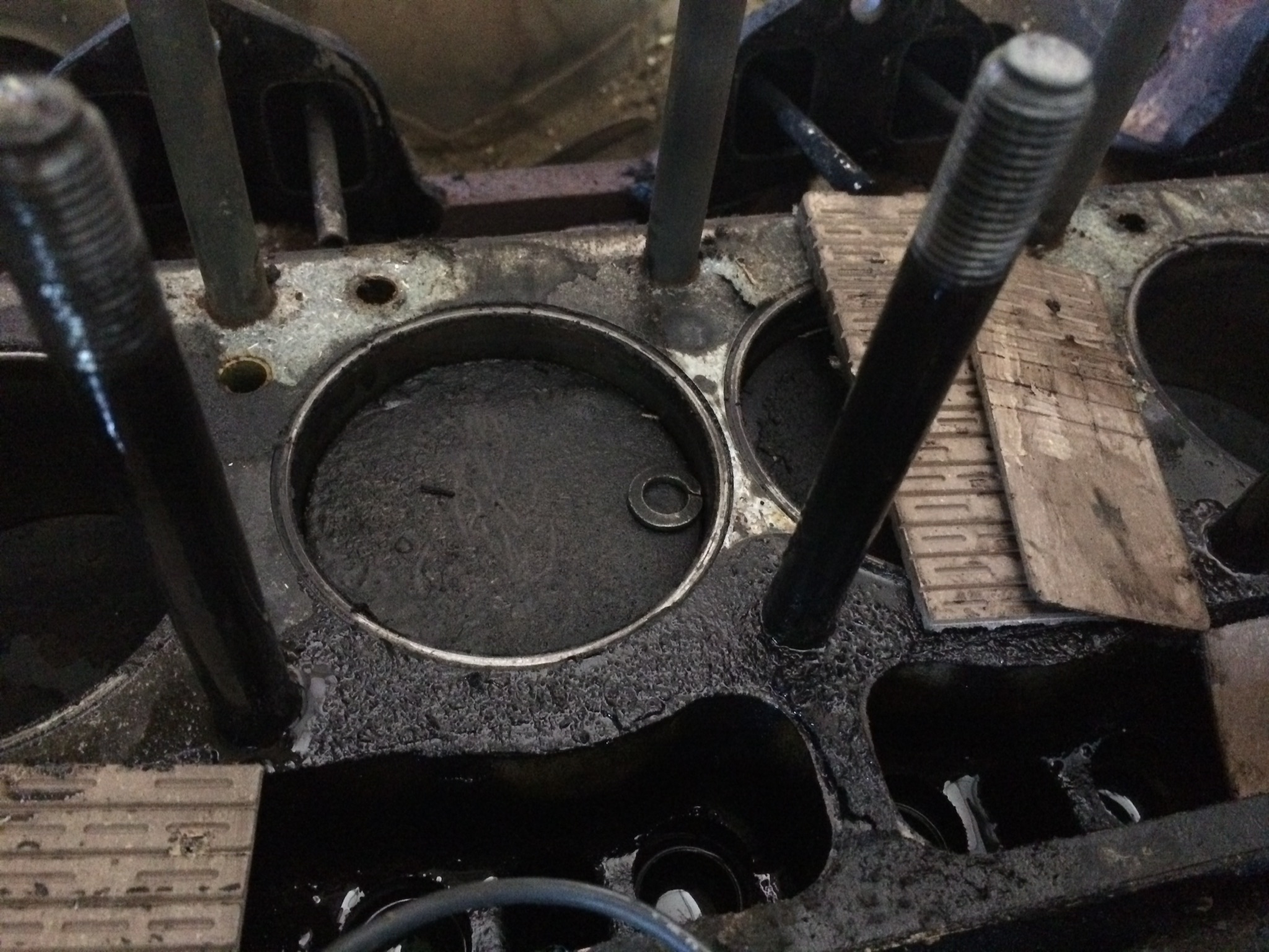

A couple of years ago I bought a second TR6. I got it running and heard a strange “pinging” sound from the engine. Using a piece of pipe like a stethoscope it sounded like it was coming from #3 piston. I pulled the head off and couldn’t believe what I saw. Laying on top of the piston was a 3/8” washer.

The guy I bought the TR6 from never worked on the car; he entrusted all the work to his favorite mechanic. I’m sure his mechanic dropped it in the intake and just went and got another one and returned the car. Sheeesh

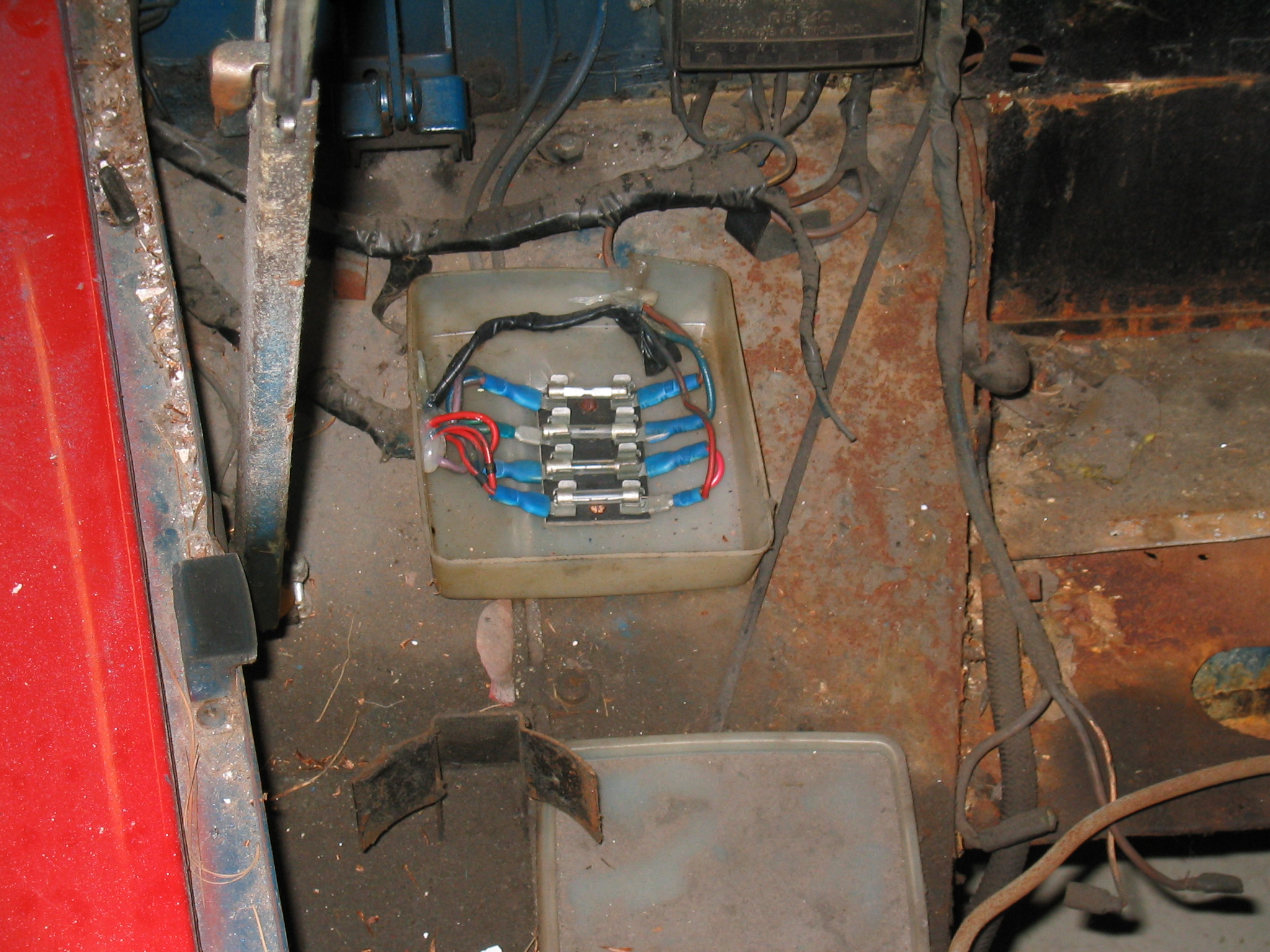

My Bugeye was the same way. Owned by electrician and everything was electrical related although not "carolated".
Wiring "sins" are one of the reasons I wrote the article about the disrespect our cars were treated with back-when. Twisting a couple wires together and taping it up was about the best they got. Some even had house wiring wire nuts holding the headlight circuits together. ScotchLocs were big things, too. Aluminum pegs connecting copper wires, exposed to atmosphere. What could go wrong!?
Great way to mess up a noble metal.
So long story is I knew about my Bugeye 20 years ago. Two club members were talking about it and I heard them say "yeah, the guy I got it from was an electrician. Wired the whole car with telephone wire"
Sure and shirt, it was along with Romex and BX.
Not anymore.
