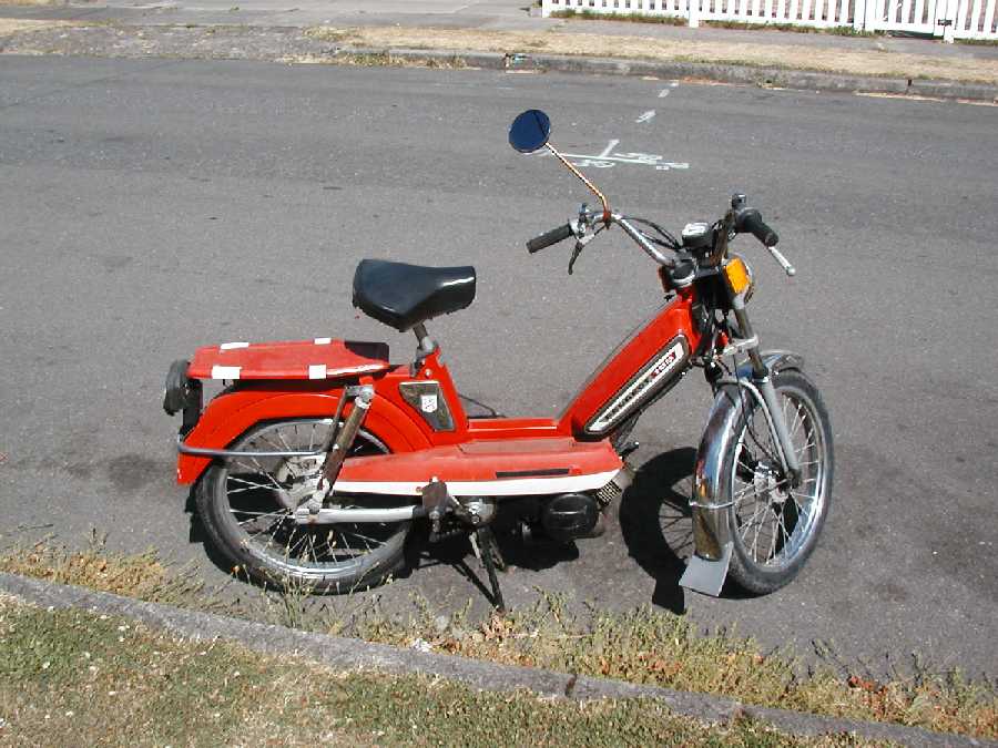

After about 5 years and about $1000.00 later my FREE /ubbthreads/images/graemlins/rolleyes.gif 1978 Peugeot 103-SP is finally RUNNING!!!!! /ubbthreads/images/graemlins/grin.gif
This is the most exciting day for me in some time!! /ubbthreads/images/graemlins/grin.gif /ubbthreads/images/graemlins/grin.gif /ubbthreads/images/graemlins/grin.gif
See attached for picture.

Plan's coming together!!
Congratulations... I'd offer to help out if you needed it.... /ubbthreads/images/graemlins/yesnod.gif
You could easily put your Peugeot in the back of my Peugeot. /ubbthreads/images/graemlins/jester.gif
But you won't be needing that sort of help, will you... /ubbthreads/images/graemlins/nonod.gif
Happy Vroooming....

Cool! and Congrats....looks like fun.
Hey, I got my 'free' electric scooter running today...must be a good day.
Interesting ride there... Looks like it would be very dificult to keep up with traffic on anything other than a residential side street though. /ubbthreads/images/graemlins/thumbsup.gif

Well the moped IS running, but now I have to figure out how to get the lighting to work. I replaced the old stock ignition with a newer electronic ignition and the wiring loom isn't quite the same. I got the lights to come on with some creative jury-rigging but they seem very weak. At this point that is the least of my worries though. It is such a relief to see that big FAT blue SPARK! It springs to life on the first kick every time, it accelerates well.... and I was starting to think this day would never come.
