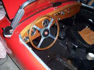

Thanks for the feedback. I did not realize there was any padding anywhere but the top/bottom dash pad portions. My car came to me with the rear surround raw aluminum and the top of the doors raw (stainless?). I don't remember stainless plates by the screws on mine. Maybe I'm missing some hardware? (See picture) I don't have an original top crash pad either, mine was made of wood by some PO (hey, it looks ok really..for now). Rather than try to hunt down one to redo (if anyone has a re-doable out one I'd be interested though). I considered simply putting vinyl over the wood, maybe with some foam in the mix. I'm reworking an original dashboard too, slowly working it back to "correct" more because I enjoy it than because I think it "needs" to be. I actually don't mind the wood look but I have a dash already and winter is project time so I launched into this. It is a little goofy. Bryan says it's a Chris Craft Midget.

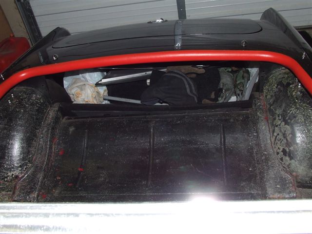

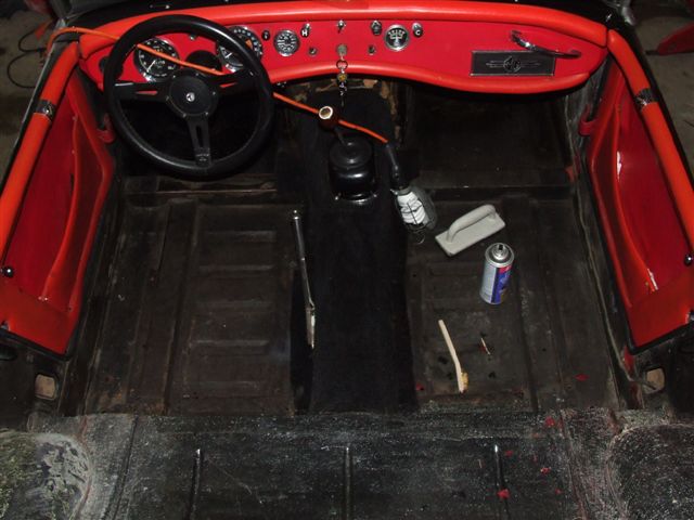

Jeff, the sprite and early GAN 1 came with the unfinished surround. The GAN 2 had the padding all the way around.
A couple of pics from when I was doing the carpet last year. They show the cockpit surround.
Bryan
