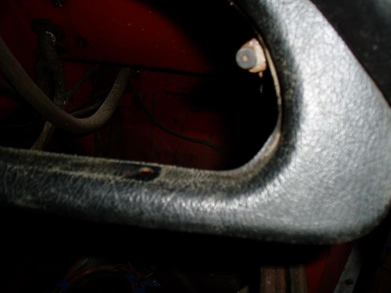

This was, I believe, the original dash covering on TS39781LO. It was already obviously old when I got the car in 1983 and certainly not changed after that.

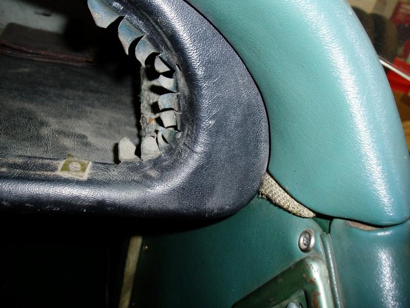

At the very top of this shot, you can see some of the clips that were used

Thanks for helping clear that up. Randall, you jogged my memory. I do recall on the 59's having the clips and some of the vinyl cover that was left on the dash, and I used the widely used vinyl covers sold by Moss or TRF to restore that one. Tom your photos verify exactly what I was talking about. The tolex PeterK mentions, seems to be thicker but is indeed similar and especially so, when I think about the vintage black Fender amps. This stuff reminds me more of the blister packs they package things in these days that is guaranteed to cut you finger when you open the package... but slightly thicker. Maybe someone will chime in that knows exact what it is and how it was installed/formed. I would guess it's not something that would be easily duplicated in a restoration.
