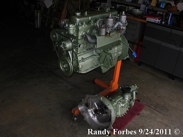

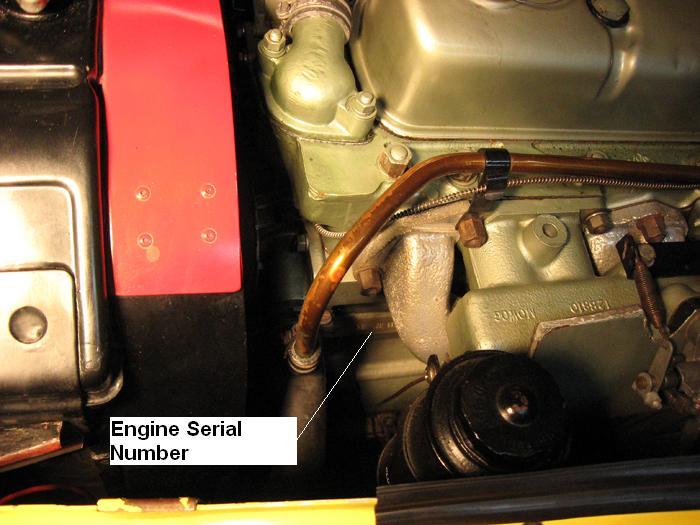

Hi, I am new to this forum, I just purchased a BN6? in very sad shape. This vin tag is missing but the batch and body number are still on the firewall. DOes anyone have a picture, or can I be directed to a picture of where the vin is located on the shock tower. I am reading a lot of description on the board but they really dont make sense to a newbie like me, a picture would help. Also where is the engine number located. I have seen several pics of engine numbers on the web, but they are close shots and don't really indicate where on the engine they are located. I have restored several german and american cars, and have owned two TR6s, but this is my first Healey. Pics always help to get the job done. thanks a bunch, Bob
Here is a pic that was posted in another thread today. You can see the engine number tag forward of the motor mount, below end of exhaust manifold.

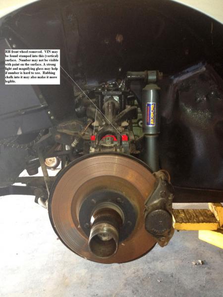

Bob, the only cars with the VIN on the shock tower are BJ8s, and possibly not all of them. Mine has it. As mentioned in earlier posts in this thread, the shock tower number found on other cars is not a VIN.

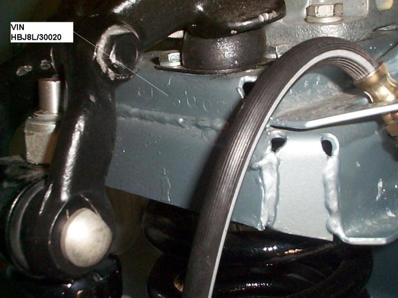

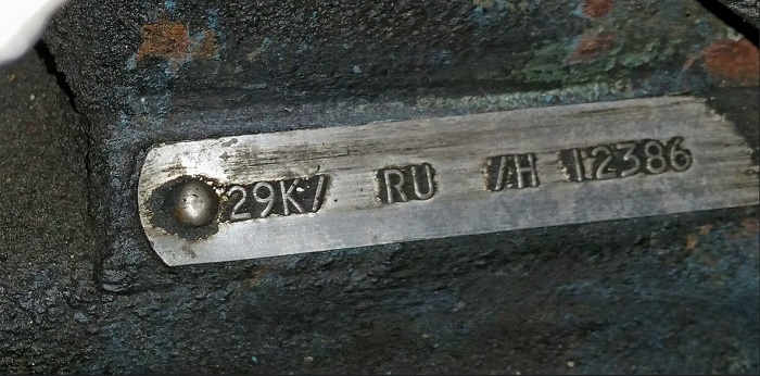

Here is a photo of the VIN stamped into the right front shock tower of a BJ8. I know only about BJ8s, but previous discussion has said that earlier models do not have a number stamped here.
The 3000 engine serial number is as shown.
To find out the original VIN that belongs to your BN6 batch/body plate, you will probably have to contact the British Motor Industry Heritage Trust (https://www.heritage-motor-centre.co.uk/archive-services/). For BJ8s, I can very probably identify the original chassis number that goes with a given batch/body number.
