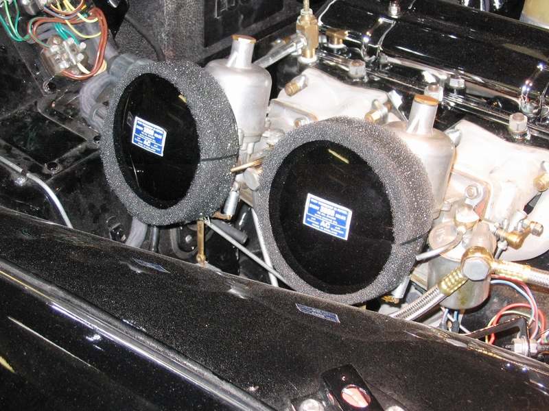

During VTR at Valley Forge in 2007, I had all kinds of "vapour lock" problems and I traced it to the fact that USA had recently 10% ethanol added, whereas here in Canada, we didn't have it yet. So I changed the rubber hose that feeds the float bowls and I've had no problems since with any type of gas in over 14,000 miles. The rubber hose on mine is the braided stainless covered one with the banjo fittings. I had a hydraulics repair shop make it for me with modern rubber and it's been fine ever since. They told me they would have made it out of teflon but didn't have that size in stock.
BTW, it was Randall you suggested that my 50 year old rubber hoses were probably expanding (swelling) inwards because of the ethanol and this caused the blocking off of the fuel flow.

Here's a shot of the heat shield going in on TS13571L. Easy project, would have taken less than an hour if I hadn't found other things to attend to at the same time. Once the carbs and filter are installed, the heat shield is pretty well hidden from view. If it was painted to match the inner fender, it would look right at home. (On my car, anything shiny under the hood looks out of place :smile: )
