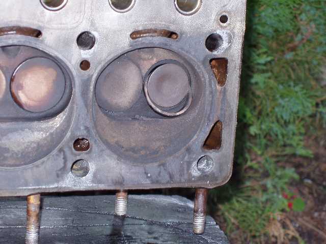

Here's a photo of #1 on the 'recessed' head. Not so bad, but you can see the valve head is lower than it should be.
But here's the show stopper; #4.

Whoa, that is a show stopper and that would be the supposedly 'hardened' seats that receded like that?
I guess that means there are hardened seats and then there are hardened seats.
But you've had stock (unhardened) motors that have done fine on unleaded.
Did you ever figure out why these hardened seats reacted like they did?
Not really. It may be because I also used "racing" valve springs with them; or it might be because I had the head milled too much (though I don't see how that would affect the valve seats). Or it may be that the shop I paid to install them ruined the hardening somehow. Might even be that the seats themselves were defective.
