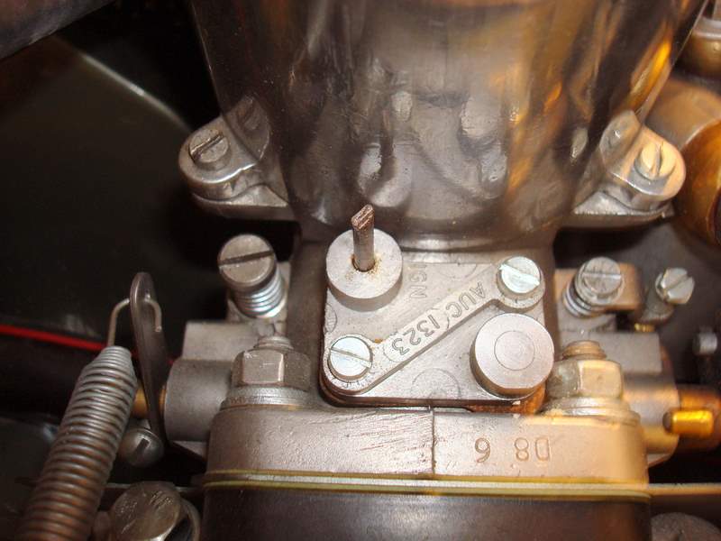

My car is setup with a Mallory dual point w/o a vacuum connection. The small copper vacuum connection at the carb is pinched off. The engine seems to run ok, but I am wondering if anyone else has this sort of setup?
Why would the PO pinch off the vacuum advance connection and not use a distributor with vacuum advance? Any advantage to this setup?
It is pinched off because the Distributor he chose to use does not utilise vacuum advance and he did not
want a vacuum leak at the intake manifold to upset the carburetor mixture adjustments.---Fwiw--Keoke
