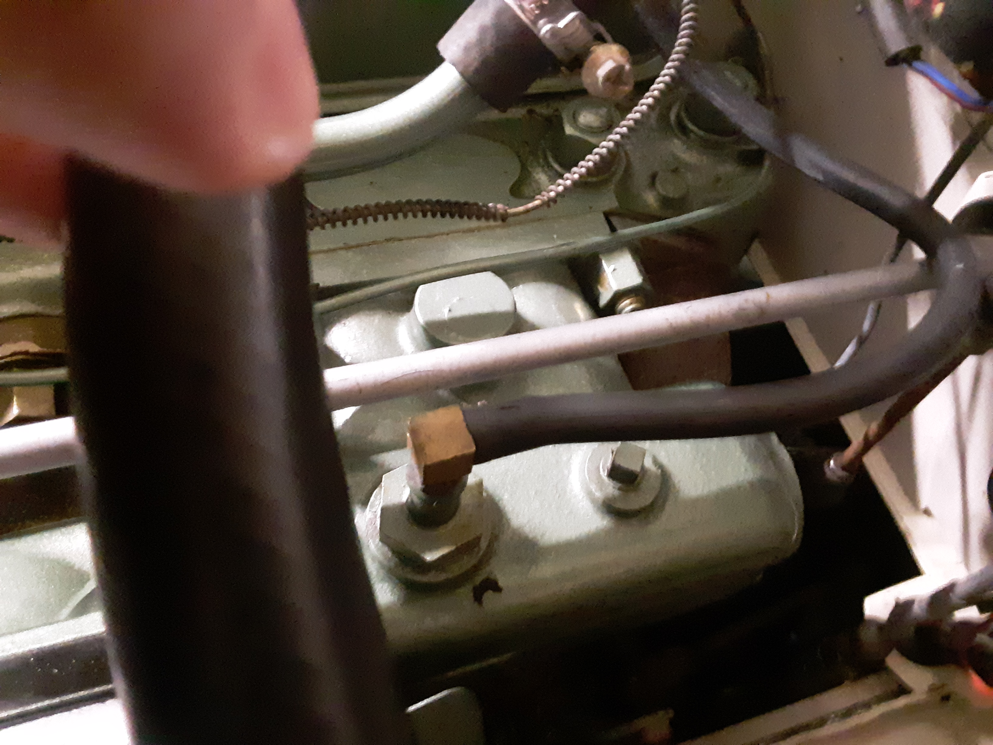

Can you show photos of how you hooked up the vacuum gauge, etc?
B
bdcvg
B
bdcvg
So this is probably the feed for the power brake booster. I got rid of the wretched power brakes so long ago I forget. The tube goes to a Smiths vacuum gauge in My dash. The smaller threaded fitting would probably work.
Patrick67BJ8
Thanks for posting photo I agree with you that the smaller threaded fitting would also work too.
