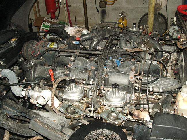

This "example" was gone thru about ten years ago. Cam covers done with a "flattened" gloss black engine paint. I pulled the carbs off and went thru 'em a couple months ago and took the pic. The "Jaguar" stickers have long since fallen off...
Owner neglects it, it sits for months at a time under a stilt house on the Gulf of Mexico, largely exposed to the elements. Ugh.
I think I know why I have been confused. It looks like there are two styles. The one pictured above does not have the Jaguar logo machined into the cover but used a sticker that showed the Jaguar logo in gold.
The other type like what I have has the Jaguar machined into the cover and stays aluminum colored.
Ah! Earlier car. Still semi-gloss, but with the embossed ribs and logo brushed to metal at their top. Clear coat it after sanding thru the paint or it'll peel `n flake. One of the synthetic foam paint rollers works for the clear fairly well if you don't get sloppy :wink:
