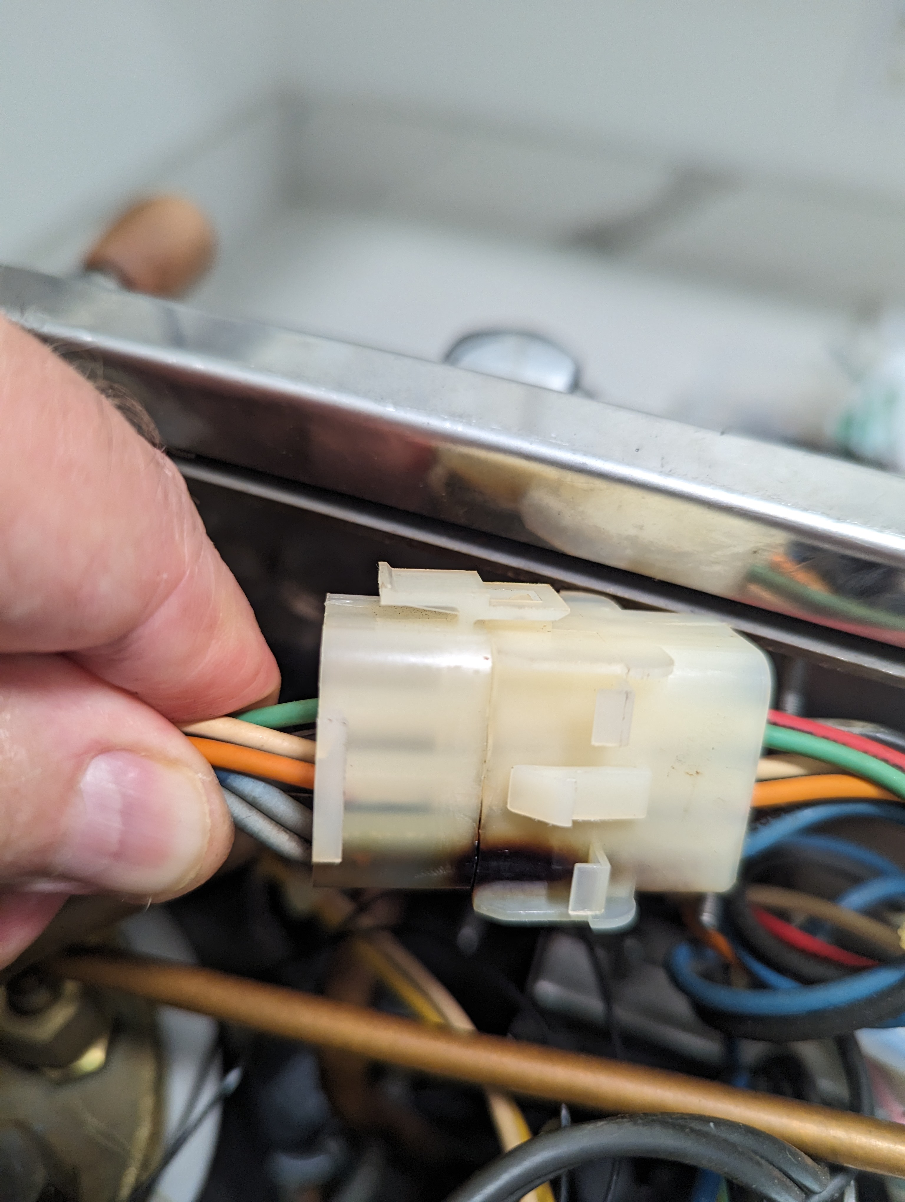

OK, that's my espresso machine main wiring harness. I thought it had just touched something hot like a boiler tube or something so I re did the molex connector and was back in business, or so I thought.
This is the new molex after about a month. I think the connector was not making good connection as it is a 110v power wire.
They use a pretty skimpy 16ga wire for all that power.
My plan is to bypass the connector and run a wire direct to the switch from the filter. No need for a connector on that.
of course finding all this on my island is a joke so I have to bring stuff in which is a 3+ week wait
I stuck my Thermopen on that wire at startup while the boilers were heating and I was getting a 300 degree temp on that wire.
Resistance =heat

Its not the wire it is the type of connector, there is not enought surfase are on the connectors to make it good
thats why they get hot, you need a connector that will has 100% contact area that one may only be spade onnectors
