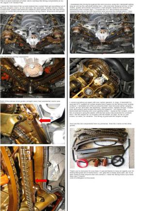

It is <span style="text-decoration: underline">done</span>.
I have attached a document (I hope it can be viewed).
Thank you to everyone for your help!
John W
