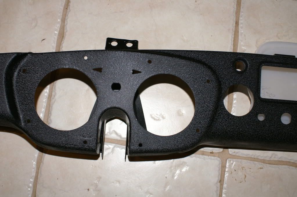

Here's all I have at this point. Need to take some more...

Mick, What's this?

DNK said:
Mick, What's this?
That's the mask for my superhero alter-ego.
Steel dash that I restored.
