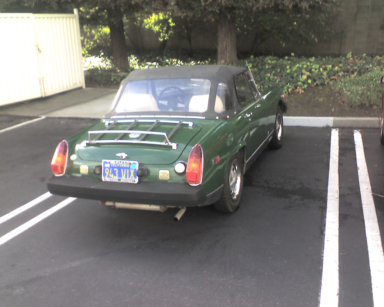

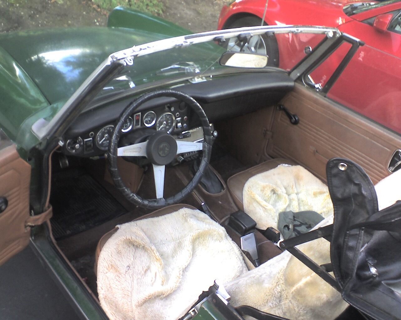

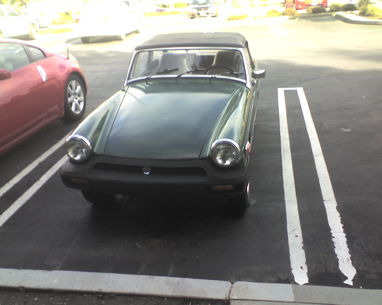

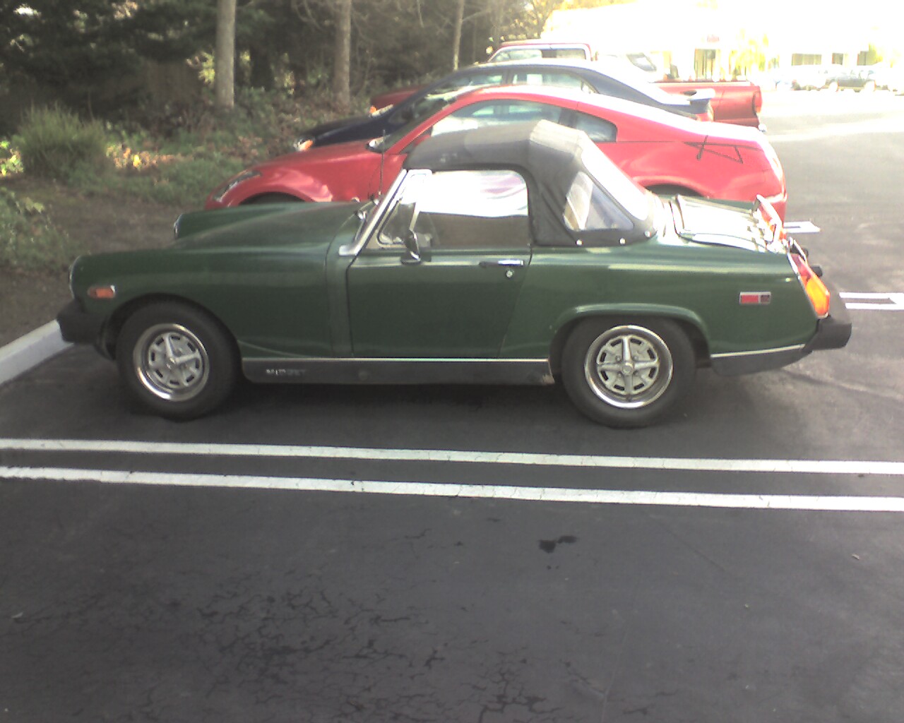

I just walked out to the parking lot and I did not see a broken leaf (not same as there is none).
While out there I took some pictures, now I am going to try and find out how to uplad em.

Re: Update on a little green Midget '77
Looks like a sound little car you've got there. Good luck.
