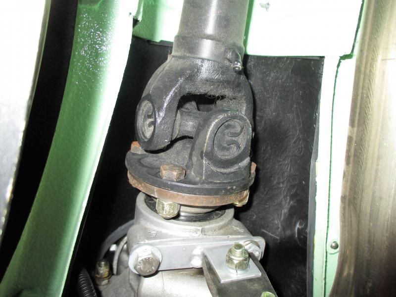

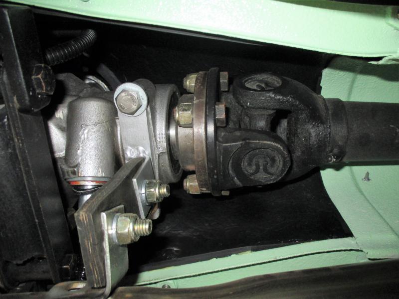

Hi Barie...These pics may assist.

Thank you Malcolm and Steve. Those pictures are just what I was looking for. The "ears" on the the universal joint on my car are sticking out well beyond the flange and they are what is hitting the tunnel. I will take it out and get it rebuilt. (Again!)
Thanks again.

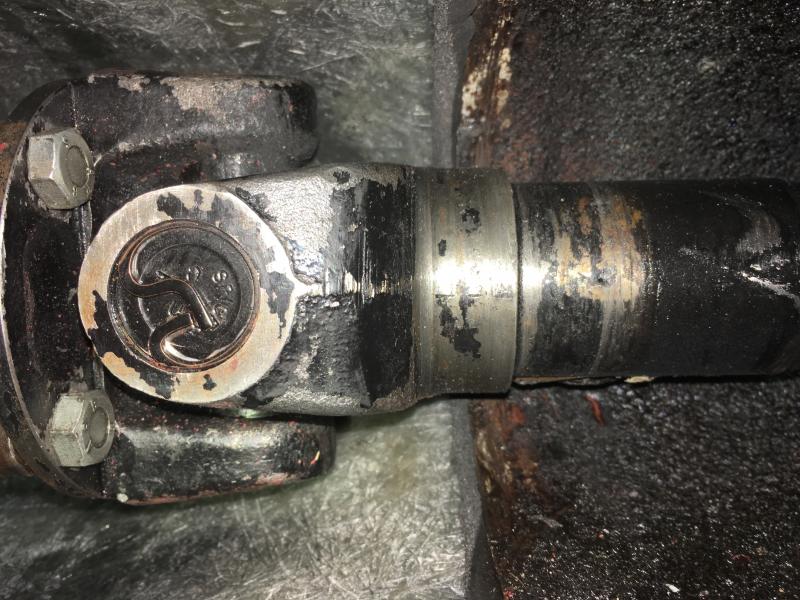

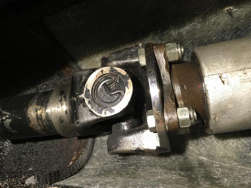

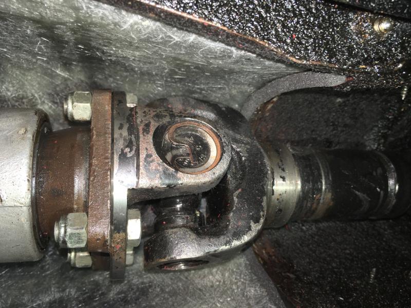

I jacked the car up last night and took some photos. You can see that the UJ is larger in diameter than the mounting flange. There appears to be a lot more metal around the cups than in the photos that Malbaby took.
I think that when the prop shaft was rebuilt last year, they used a different, larger UJ.
The car is going in to have the Goodparts roller rockers installed next week. I will get the prop shaft removed and rebuilt with a smaller UJ. I will report back!
Barie....from the pics, you seem to have a mismatch of parts.
Your pic number one is the most revealing...can hardly see the uni.
What parts are original Triumph TR.
Malcolm, the story related to a vibration that the car developed. When I rebuilt the car about 18 years ago, I tried to ensure that everything was as new. I sent the prop shaft to Hardy Spicer in Dandenong to be reconditioned. As you know, they were the company that made driveshafts for many different car companies, so I thought that they would know what they were doing.
About 2 years ago, the car developed a vibration. I had all the wheels balanced without any improvement, so I got my friendly mechanic to run the car up to 100kph on his dyno rollers, so he could look under the car and see what the problem was. The prop shaft was the culprit. We sent it to a specialist driveshaft company, and this is how it came back. When you send these things out to be fixed, you do not expect to have to give instructions about getting it back in original condition. However, this time, I WILL be giving instructions! I will use your photos to show them what I want.
