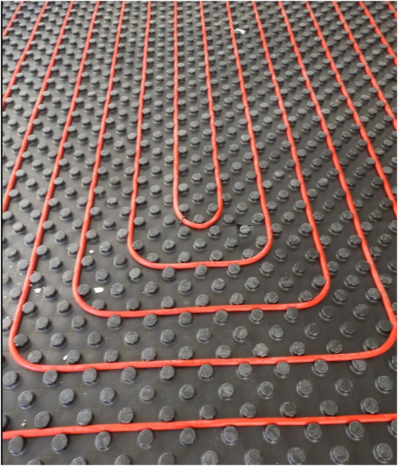

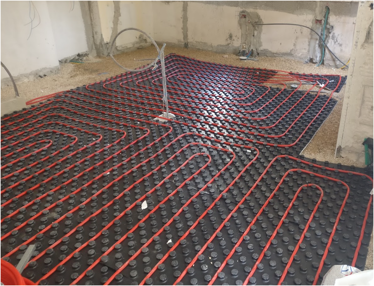

After 2 months of breaking stuff and moving walls today the heating company came in and laid insulation and warm water hoses for underfloor heating.
The black stuff is a thin layer of insulation with plastic clips to route the hoses and keep them in place. In some places they also stapled the hoses in place.
The didn't put the hoses around the edge of the room since that is where the kitchen cabinets will go and long term heating under the cabinet causes damage.
The hoses are kind of neat, with three layers, plastic, aluminum and plastic.
Tomorrow they contractor will cover everything with fine gravel and start tiling the floor.
Still need to prepare the pad outside for the heatpump.
