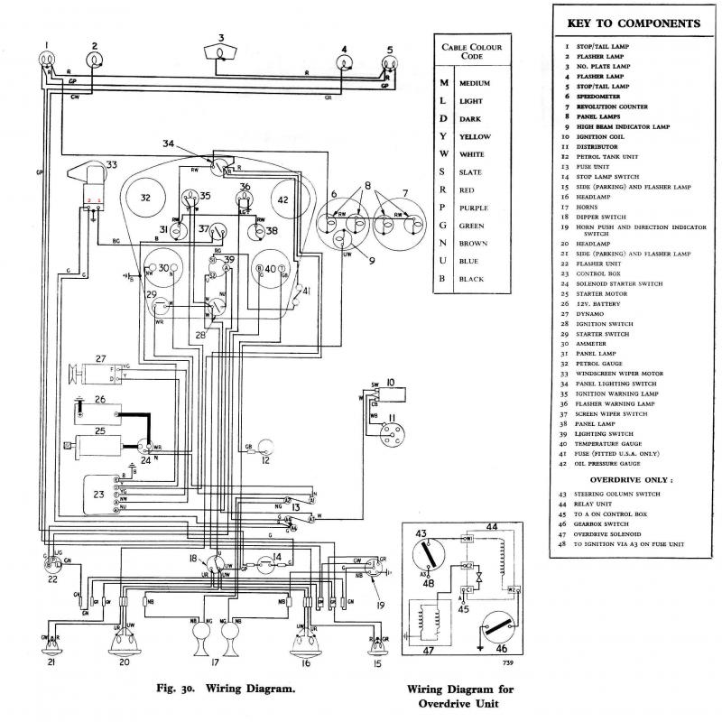

I believe that I have seen pictures of the back of the TR3 dash panel showing an in line fuse. But I can not find any wiring charts showing that. Can anybody verify the presence of a fuse and on what wire it is on?
Hello Charley
Here is a copy of a diagram I believe Randall put up. It is Item 41 on this drawing feeding the light switch.

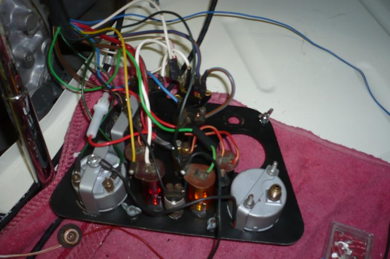

hi Charly, I could not find the picture of the fuse, but when I get under the dash again I will take a picture. The fuse started about 1959 and is in a metal canister; the fuse is in the red tail light wire and has a moveable clip on the canister that clips right in the center of the gauge panel at the bottom. The clip the fuse hangs on looks like one of dash covering clips plus when in place functions as one with those little barbs. plus very rare to find.

Thanks to all. And a belated thanks to Randall for putting together his wiring chart. I have 4 copies in 4 books of the wiring chart and none of them showed the fuse. Looking at pictures I got lost following the wires. So the fuse goes on the power feed from the light switch to the panel light switch. I would have guessed that it would have been on the brown/ blue power input wire to the light switch. But that would have put a fuse in line before the headlights.

After getting the information, I went out and found an original fuse with red/green wire to fuse to red wire on an old TR4 wiring harness. I also found the clip that the fuse holder goes in.
