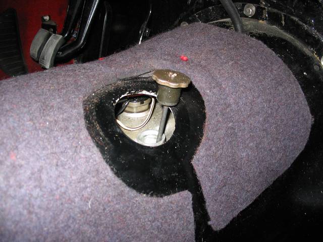

My TR3A came with two pieces of undercarpet felt glued to the top of the tunnel. One is about 8 inches in diameter and surrounds the gear-stick hole. The other is as the photo attached. Note that my TR3A is an early one with the top fill hole and dip-stick. The original pieces were removed and replaced when I did my restoration from 1987 to 1990.
Don Elliott, Original Owner, 1958 TR3A
