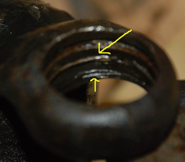

I managed to get that last clip out. I think I've discovered some damage to the driveshaft. In one of the bearing housings there's a huge ridge inside. Not the ridge where the circlip fits, it's a built-up metal ridge. It starts in the middle and circles around once in a diagonal line. Is this something that can be honed out, or should I start looking for a replacement driveshaft?

I sent Jim an email about the driveshaft from his. I'm trying to upload a picture of what I'm talking about. It's a raised ridge of metal, a little slimmer than a paper clip wire.

yep, I would not use it, it is just a problem waiting to happen.
Jack, I think you're right. I did manage to get the yolk off, and it's quite a ridge, and there's another on the differential flange. Here's my theory on how the ridges were created. Part previous installer's part, part mine. I don't believe the bearing caps were installed evenly. It took an excessive amount of force to get them to budge. In trying to drift them out The bearing cap caught and started to build up a metal ridge. I could be completely wrong in my theory, but either way my driveshaft components are hosed.
So, I'm going to purchase a new flange, see about Jim's driveshaft, and send it all to a place that can put them in plus balance the shaft. Lesson learned.
