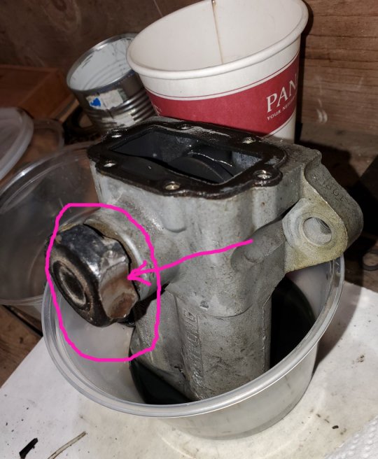

Got in the Sprite the other day for a drive (having driven it with no issues a week earlier) and it made a horrible clanking/clunking sound... from the right rear. At first I though "junk in the trunk", but no amount of re-arranging mattered. Jumping up and down on that fender produced the noise, so I climbed under and found that the Armstrong shock lever had sheared right off! Never seen such a failure (nor had friends). Opened it up to examine, but it seemed OK.
Took the opportunity to replace both (with re-built ones from World Wide)... and all is now well.
