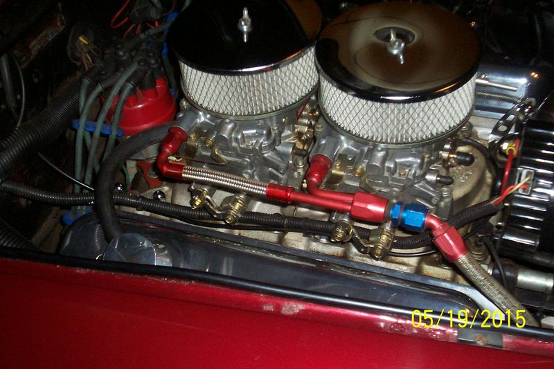

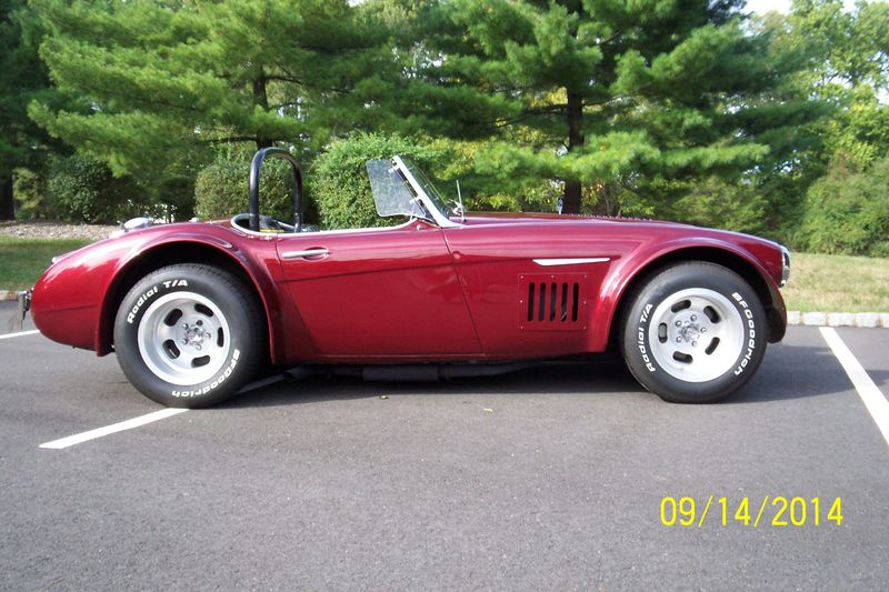

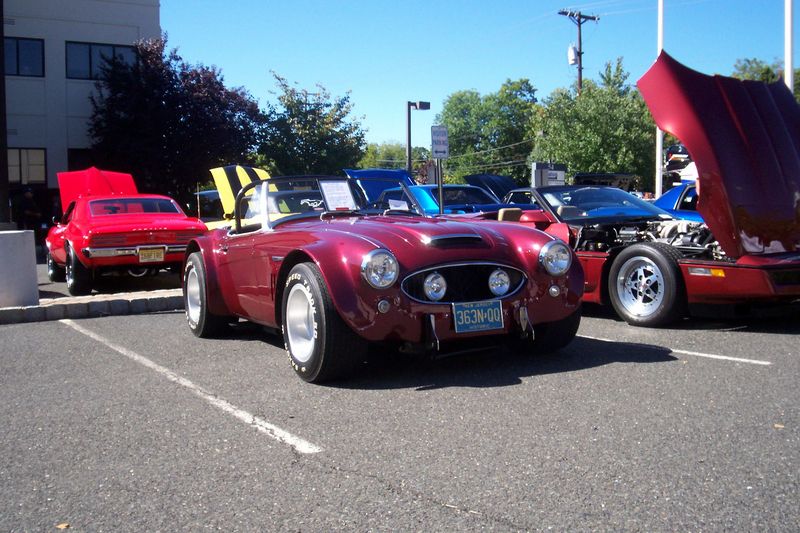

i finally found an affordable 59 bn6 with a v8 drive line. i recently sold my stock bn6 because i wanted a v8 two seater. i already have a v8 bj7 but it is not nearly as handsome to me as the two seater bn6/7. the one i bought is a bit outlandish and needs considerable attention to bring back to a more original look! it has a sbc motor and transmission. the person i bought it from had owned it since 1976. when he bought it it had an early corvette fuel injection motor. he later sold that but kept the four speed. i got it at what i considered to be a good price and hope it is delivered next week. my plan would be to replace or modify the flared fenders, the wooden dash and gauges, seats and put widened original healey steel wheels with stock healey hubcaps on the car. footboxes are a mess. constructive comments are appreciated but i wanted a v8 two seater and not an original six banger.

Looks like it's pretty close to the same color as mine; Porsche Wine Red (early 70s 911 color). When I first got my BN6 (1978) the son of then Pacific Centre AH Club President, Lou Busch (sp?) was building pretty much the same car. In his case though, I believe the extra weight of the Bondo flares offset and gains in HP the SBC provided!
I like your plan; tone down the looks a little bit, but keep it wild under the hood :smile:
