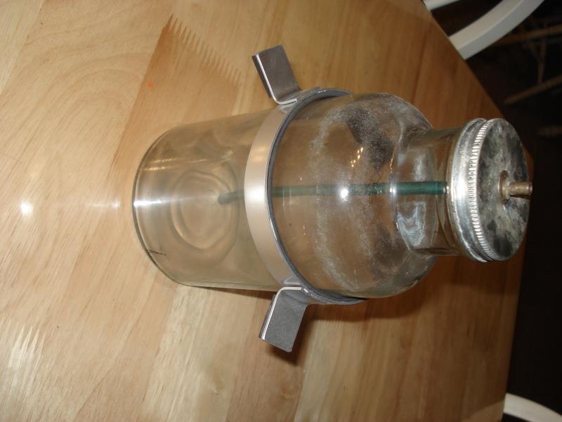

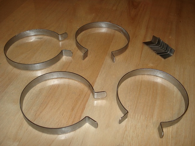

Jim on here (aka healey blue) made his own bracket for the glass jar, and it seems that he posted a really nice drawing of it too.

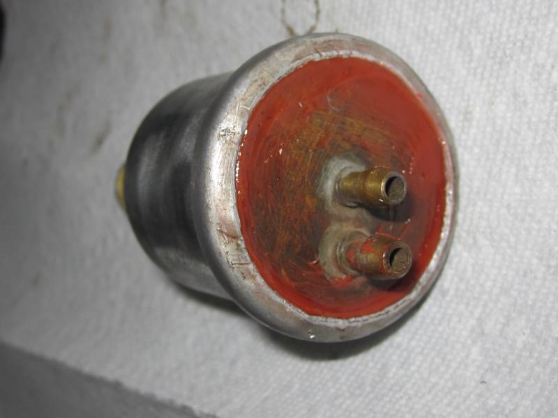

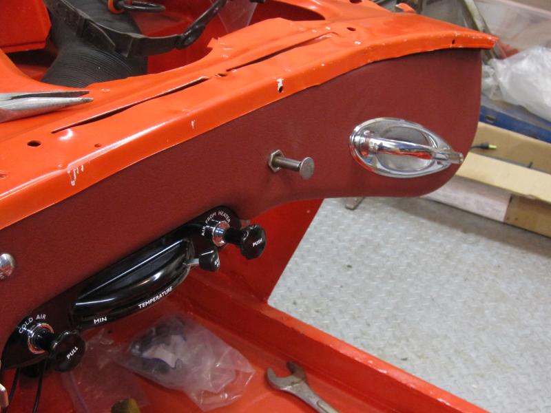

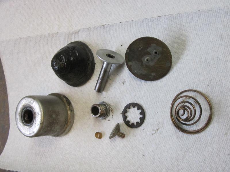

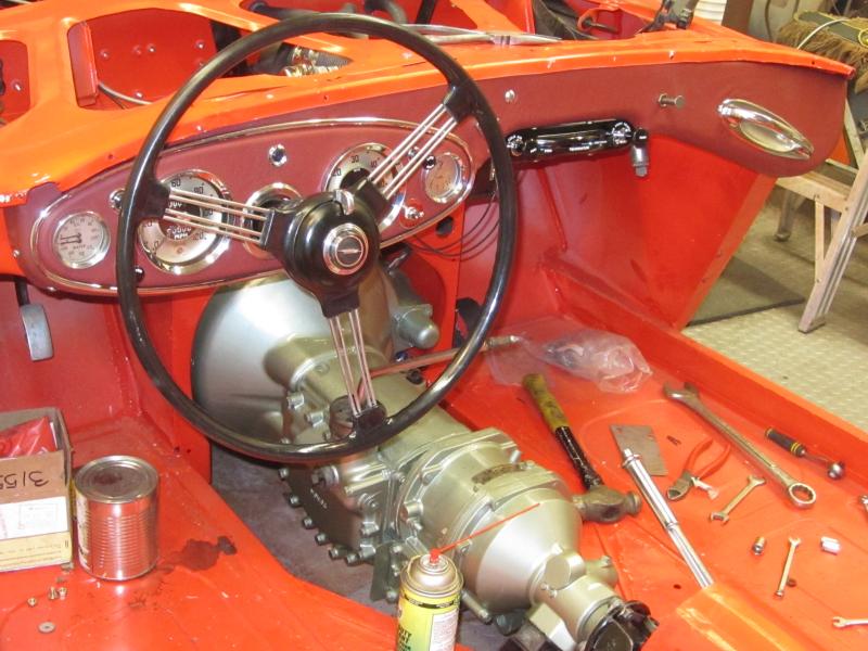

Soaking the threaded nut at the front of unit finally worked today; it was part of a surplus dash panel - the only piece left on that panel. On closer examination, the rubber cone shaped part inside seems old, but free of holes and still flexible. The part of the cone that originally fit over the rear disc has disintegrated. So, on reassembly, I used a bit of RTV type sealant in an attempt to seal the cone to the metal disc. Once the RTV sets, the unit might actually work to pull and push liquid. At least it will do until, if and when, one in better condition comes along.
Here are a few pics of the pieces and of the unit installed in the dash. Assembling the dash was fun; sort of like doing a jigsaw puzzle. I was going to cut a hole in the face for the choke, but, fortunately, came across information that the early Longbridge BN4s had the choke mounted underneath the dash. A search of the parts pile that came with the car then turned up the original choke brackets and choke unit, in usable condition. I wonder whether there is a source for a good reproduction unit? Now, to remember that the choke control is hiding there under the dash . . .

send me a private email. I may have what you need, the bottle, the cap, the tray, I just have to check my basement
