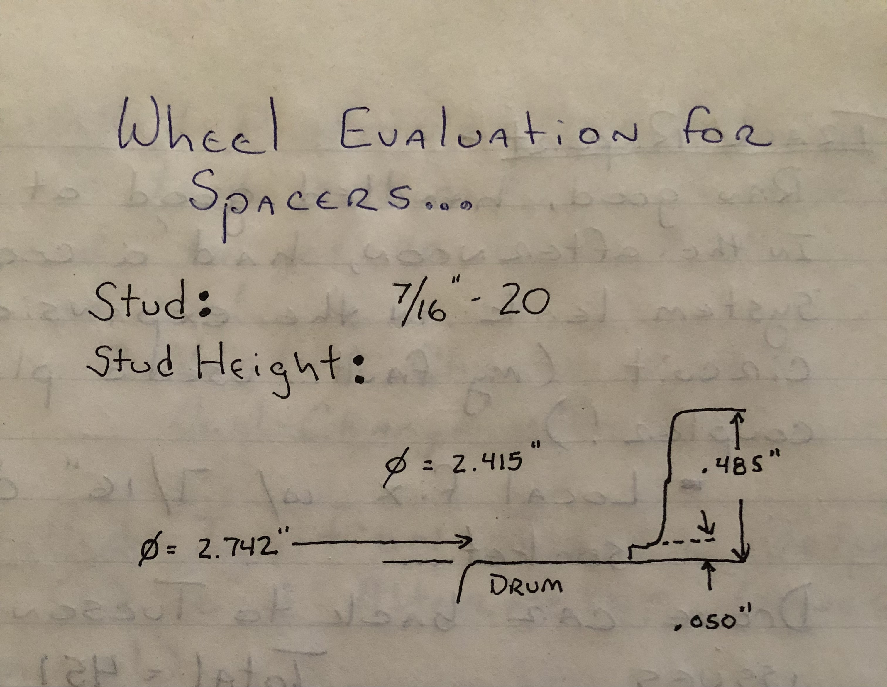

I’m rethinking my Revolution wheels…. But I need spacers to move them out so I don’t foul on the suspension parts.
So are TVR (specifically Vixen 2500) wheels registered on the lugs or on the hubs?
And if they are hub-centric, do the rears register on the very short (.050”) surface that registers the brake drum, or the much taller (.500”) surface above that one?
Thanks -
Rocky
Lugs. The wheel rear face mates to the drum.
