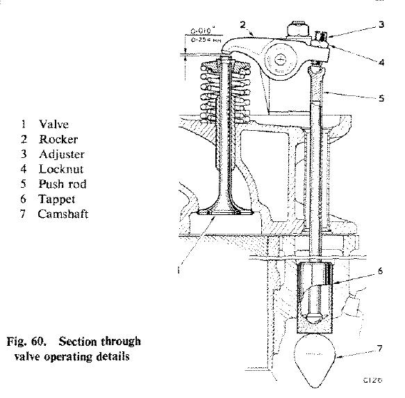

I just want to add that the Macy's Garage article directs that if the Rule of 9 is used, adjusting to the designated valve is done not when the valve if fully open, and but when it just starts to close--I believe just slightly past the high point of the lobe. In other words, by assuring the valve was fully down, but just starting back up to close (i.e., the cam lobe is rotating down), the timing is right to adjust the valve which when added to the one just beginning to close equals 9.
When not using the Rule of 9, according to the Article, you just go cylinder by cylinder and: a) adjust the intake valve when the exhaust valve on that same cylinder just starts to open; and b) you adjust the exhaust valve, when the intake valve just starts to close.
