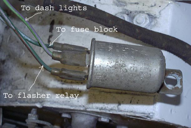

Does your flasher have more than three terminals?
<span style="color: #3333FF">Hmmmmm.... Two terminals that go to the lights. One that goes to the dash... Yep, it has three.</span>

<div class="ubbcode-block"><div class="ubbcode-header">Quote:] Hmmmmm.... Two terminals that go to the lights. One that goes to the dash... Yep, it has three.[/QUOTE]
The reason I asked was on a three connector flasher, one lead goes to the relay (all turn lights on body), one goes to the dash. The third wire is hot input from the fuse box. Of the three mentioned, none was the power line.
Hey... that makes sense! Thanks, and I'll let everyone know. If it's not it, I'll be back begging for help!!
