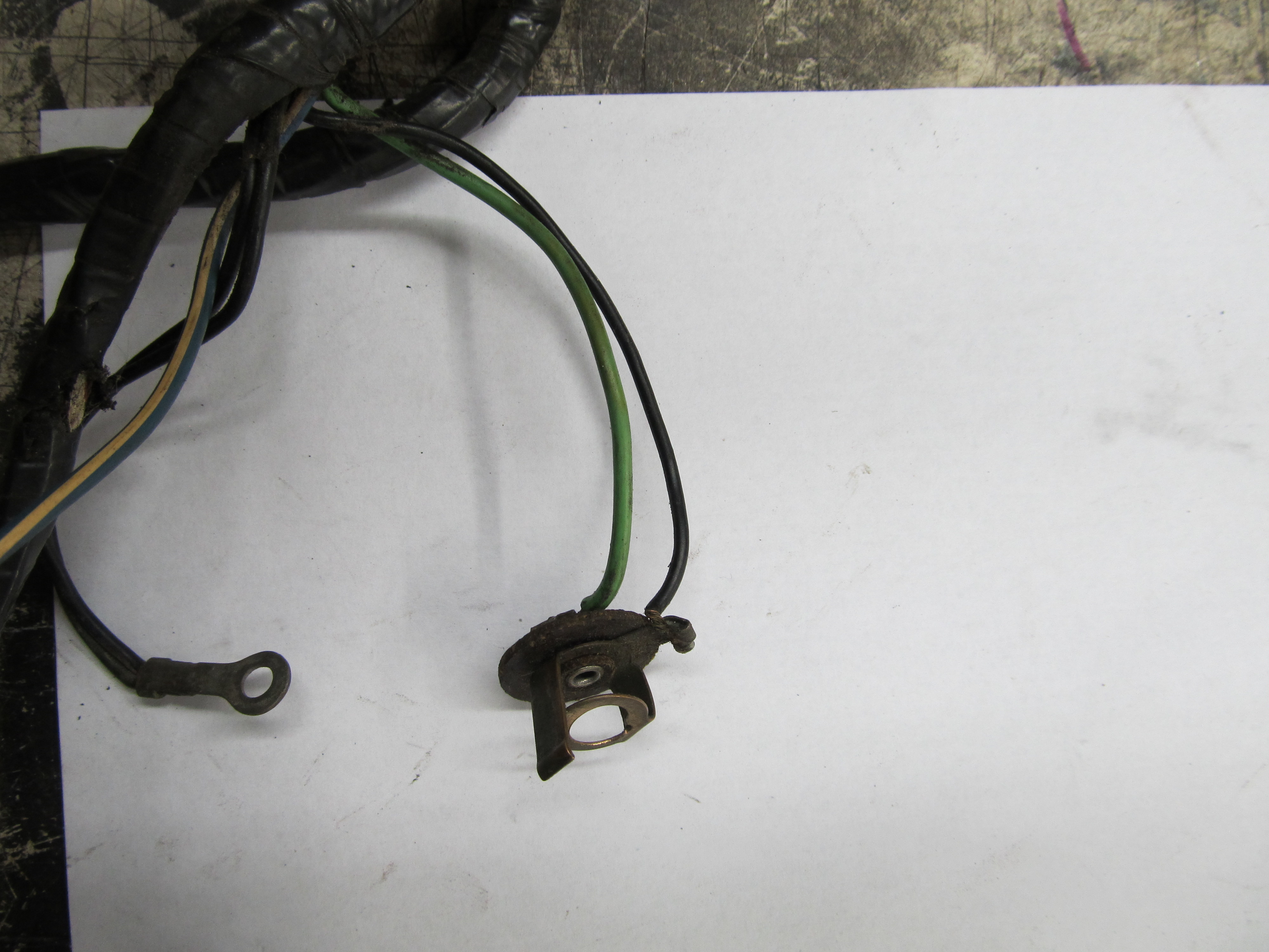

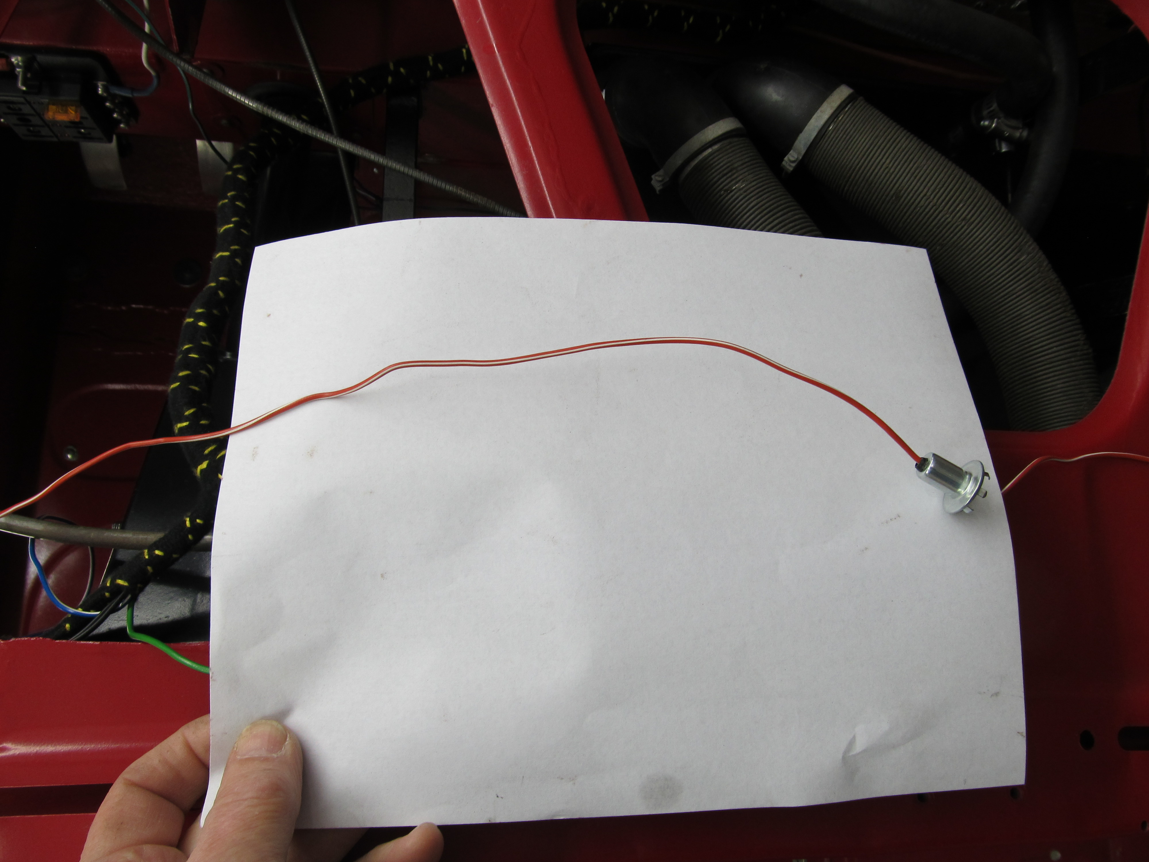

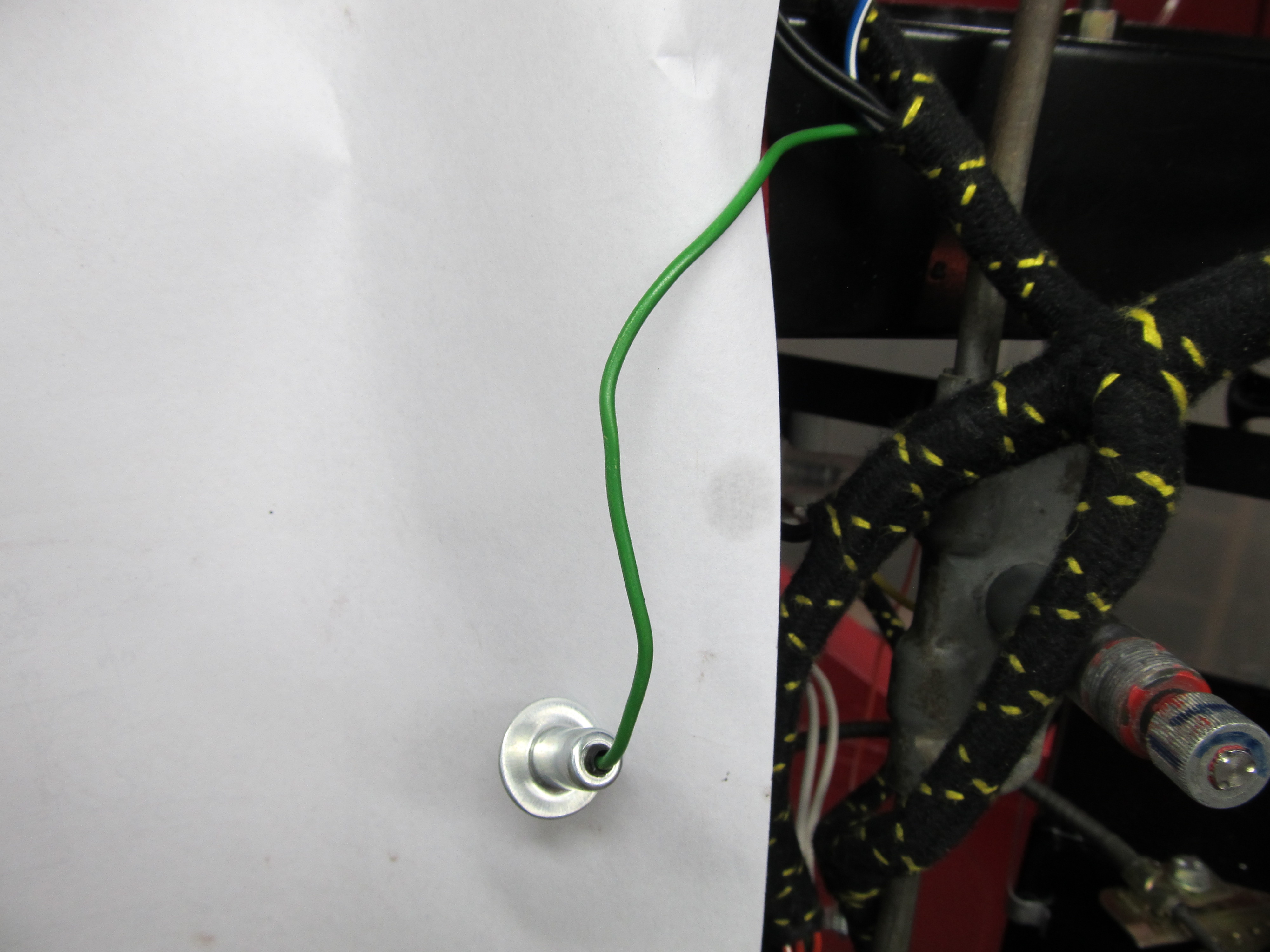

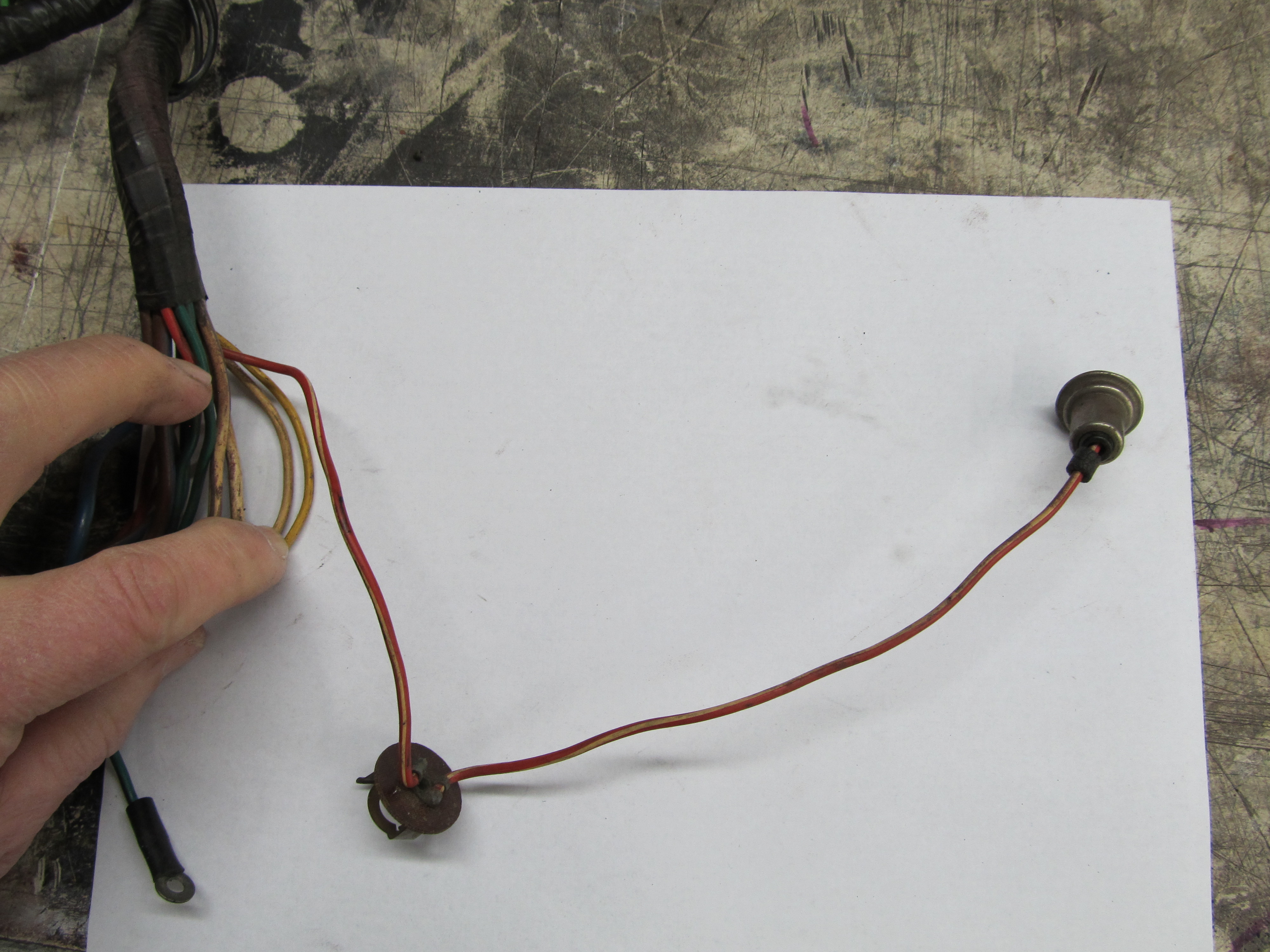

Not sure if this will help but you say you have a new wiring harness. I had a problem with a new harness from Moss a few years ago. I'm not sure who made it, but it seems to be a common problem with the new harnesses available (from several suppliers at least).
My new harness came with a single wire socket for the flasher indicator light which would rely on the socket base for ground but the green plastic tube the light bulb & socket plug into cannot supply ground.
The original was a two-wire socket because of this.
I was told that there are no sources for these 2-wire sockets so they just used a commonly available single wire socket.
The new harness was also missing the light sockets for the combination gauge and the fuel gauge.
The solution was to transfer my original 2 wire flasher socket to the new harness. I also added the two sockets for the combo & gas gauges
1st picture - original 2 wire flasher socket.
2nd picture - new single-wire flasher socket.
3rd picture - original tach & gas dash sockets (speedo & combo same)
4th picture - new tach, no gas socket (tach & gas same)
Another example of the marginal stuff being sold to us these days :smile:
Dave
