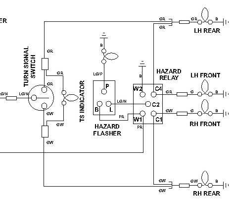

My turn signal indicator light on my TR250 was very dim, I recently replaced it with an LED light, which seems to be much brighter, but....it only works if I indicate a right turn, are LED lights "handed"? could I have gotten a right hand only one.....just kidding. I am no electrical genius, but not that bad.
I suspect the voltage is lower n the left turn signal circuit (it has always blinked slower than the right one) I have checked all the connections and they seem good. I have a multi-meter and know just enough about how to use it to be dangerous, is there a way to try to track down the source of the voltage drop?
Bingo !
Seriously, LED stands for light emitting DIODE, meaning they only work for one polarity. The TR250 turn signal indicator relies on the fact that incandescent bulbs don't care about polarity.
Talk to your LED vendor, they may have a unit that provides for operation with either polarity. Otherwise, you'll have to rearrange the turn indicator circuit to use a (or two) LED.

The LED sure makes a nice bright light, if I wired it up with both green/white and green/red going to power one side (middle contact on the bulb and bulb holder), and grounded the other side would that work, our would that mess up my turn signal circuit? Like both sides would light at once or all the smoke would come out?
No smoke, just both sides light up at once.
Some possibly workable alternatives:
1) Use a 3-terminal flasher, connect the dash lamp to the 3rd terminal. That's how the TR2-4A are wired.
2) Use two LEDs (possibly even in the same housing), so you can wire one to each side.
3) Insert a diode bridge between the LED and the original turn wiring https://www.jameco.com/webapp/wcs/stores/...WSF&CID=GMC
4) Add a relay with its coil wired in place of the original turn signal indicator bulb, and the contacts switching the LED.
5) Use two diodes (rather than the bridge), and wire the other side of the LED to ground.

Shouldn't be hard at all. The bridge has 4 leads, marked ~, +, -. The two ~ leads go to the original wires. The + and - go to the LED anode & cathode (+ and -) respectively.
