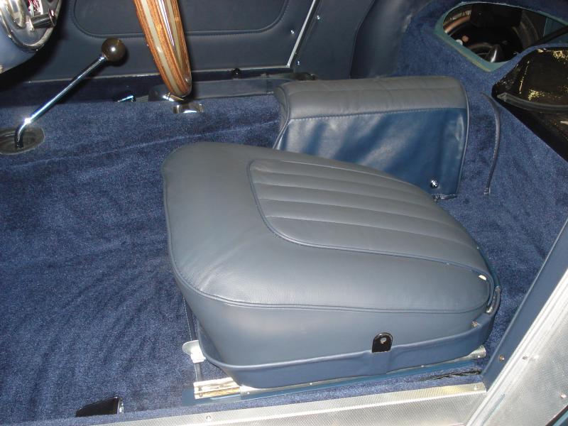

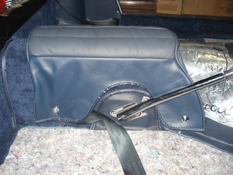

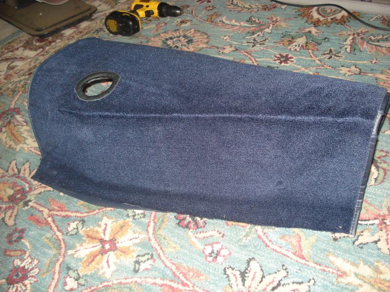

Yes it will definitely make it easier for trans access. Longbridge model here, and ours is two piece. The longbridge has a deep armrest that covers the seam anyways so you can't tell its two piece, but I think it was two piece originally anyways.
