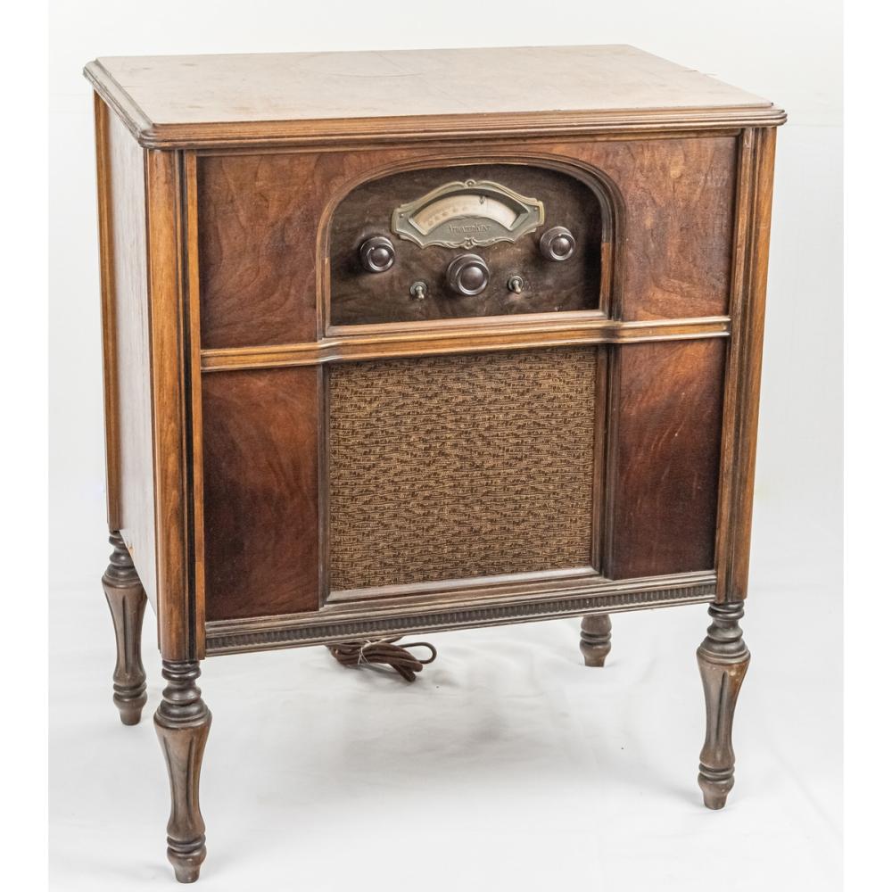

My 1930 Atwater Kent is showing its age. (and so am I ...)
Power on, adjust the volume about midway, sound is excellent. Good for voice as well as music.
Then after about 30 minutes, suddenly the volume doubles. Wham - have to race to turn down the volume.
I'm guessing it's a heat issue, but need expert opinion on diagnosis and repair suggestions. Seems strange that heat might cause an *increase* in output, without cracking, popping, or static.

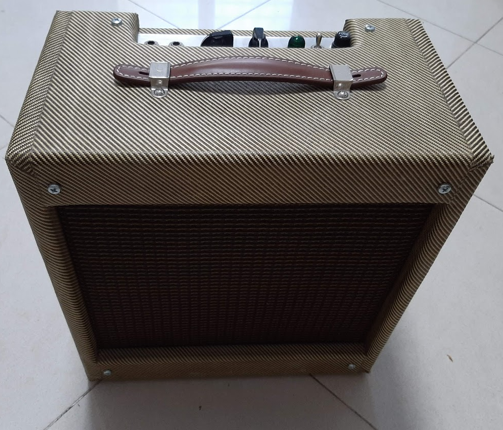

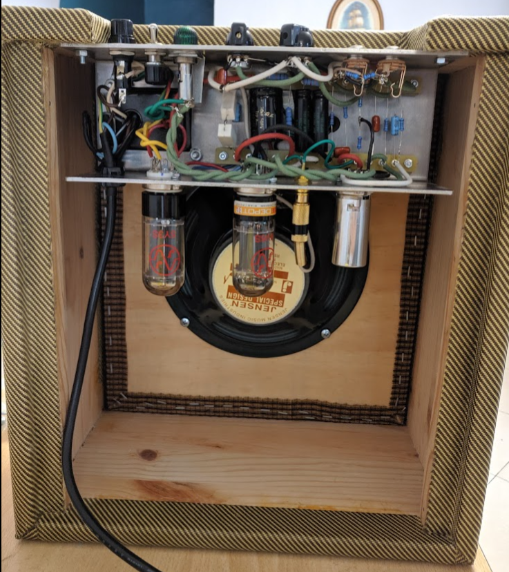

Here is the little Fender I built a few years ago
